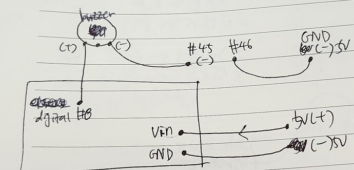

This is my current circuit. It works fine, when I connect #45 and #46, the circuit is completed so the sound is successfully generated via buzzer.
However when I disconnect #45 and #46, there is a leakage current to the buzzer, around 3V, and generates small sound.

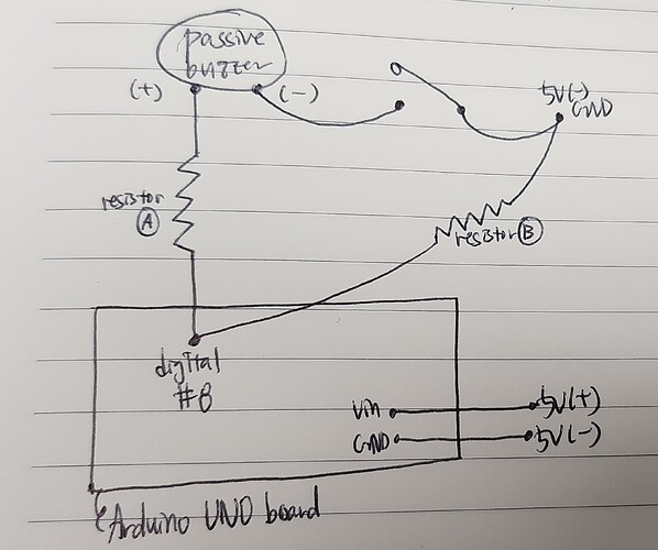

To prevent this, I will use resistor A in between, to make sure the current leakage goes below 3V, maybe around 0~1V.
But when I only use resistor A, the sound won't be generated even when I connect #45 and #46. So I thought of applying a different resistorB between #8 and GND, and use resistorB a higher ohm compared to resistorA. I think this way, I can achieve my original goal of operating sound, and also control the leakage.
The problem I am facing is, which resistor should I use for resistorA and B. I want to calculate by myself with the ohm's law, but I don't know how.
FYI: I am using passive buzzer KY-006, and I cannot find the buzzer's default resistance.

Yes that thread is what I am using and the picture is the relay system, which #45 and #46 is located. I have a relay system and a program already, so when I click the button in my program, the relay's #45 and #46 will be connected. This way, the circuit is complete, and since the 5V(+) power supply is always provided, 5V will go to passive buzzer and all the way to the ground, which generates sound.
When I release the button in my program, #45 and #46 will be disconnected, so I originally hoped there would be no sound at all. But idk why, there is a leakage of around 3V in the passive buzzer when I release the button. Because of this, there is a small sound generated.

I can't follow your description, neither drawings.
I think it would be easier, if you just tell what you want from your circuit.
Buzzers generally don't need relay, you can drive them directly from arduino.
And relays generally don't have any leakage.

That behavior you explain sounds bad wiring or soldering or components. You should fix that. Relay output has physical gap, there can't be leakage. Also you should not control regular relay directly from arduino pin.

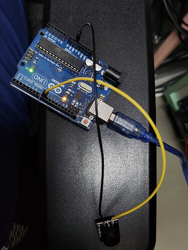

I connected the buzzer-arduino board. And uploaded the code from the link. It is generating high and low sound in loop.
so it's working...
Yes it is working fine. Also works fine with my relay system (when I connect the circuit via relay system, it generates big sound with the desired frequency I set with tone() function).
One problem I want to solve is small sound still generated when the relay is off, and I suspect it is due to constant 3V flowing to the buzzer. It would be best that I can regulate between 0V and 5V with relay system, but since I don't know how, I would like to use a resistor to lower the constant 3V.

Your relay circuit is not ok, like I wrote. Resistors are not changing that fact.
@mmmmnimmn
The diagram I show in the other thread is the correct way to do it.
okay, i will try thinking new circuit that would work. What part of the relay circuit is not right? Is it because the circuit is not closed-circuit?
oh hi @jim-p . Thanks for your help few days ago. I tried the wiring as you adviced, but somehow the sound was not generated at all.. So I tried multiple circuits, and this one is the only one at least working..
