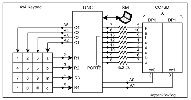

Calculator using keypad and 2 7 segment display
I need help with tinkercad, i need to make a one-digit calculator using 4x4 keypad, arduino uno, 2 7 segment displays
I need to figure out the whole coding and circuit
When a is pressed it is add, b for subtract, and d for displaying the answer, and it should also display negative number
example: 2B4D the number on the displays is -2

1. Your diagram shows that the display unit is om multiplexed type. Why have you installed 14 resistors when only 8 is enough for 8-segnets (a,..., p)?
2. What are these symbolic names: AA, BB, CC, DD, EE FF, GG?
3. When you have assigned a for addition and b for subtraction and d for display, then why have you chosen 2B4D command instead of 2b4d?
4. Do you have these hardware: UNO, Keypad, 2x7segment, and 8xresistor? If yes, then you may proceed to exercise the following tutorial.
Tutorial -- pending until you have the above-mentioned hardware.
yes
  1. how can I use 8 resistors for the 2 7 segment displays
2.i used those letters to indicate the other 7 segment display because I am not sure how to display different digits
  1. Huh? it's is the same I think
  2. yes

You can connect 2-digit multiplexed display unit as per Fig-2.
Figure-2:

Working Principle of the Display Unit of Fig-2 of post #5:
1. This is a multiplexed type 2-digit cc-type display unit.
2. A multiplexed display unit is made
(1) Short together the identical segment pins meaning: Pin-7 (seg-a) of DP0 (display number 0) will be connected with Pin-7 (seg-a) of DPI.
(2) The cc-pins (common cathode pins) of DP0 and DP1 will remain separated.
(3) Insert current limiting resistors in series with the segment lines as is shown in the diagram.
(4) Test Sketch:
Upload the following sketch and check that the display unit working as a Stop Watch counting from 00 sec to 59 sec.
byte lupTable[] = {0x3F, 0x06, 0x5B, 0x4F, 0x66, 0x6D, 0x7D, 0x07, 0x7F, 0x6F};
byte ccTable[] = {0x3F, 0x3F};//DP0-DP1 holds cc-code for DP0-DP1

ow the required output is a calculator u may view the latest version on the link I posted before
In the following Tutorial, we will build a Calculator which will add two 1-digit wide numbers by taking them from a 4x4 Keypad. The symbols will appear on the Serial Monitor as they are entered. At the end end of the entry of three factors (first_digit, a for addition, 2nd_digit) from the Keypad, the result will appear on Serial Monitor and on 2-digit 7-segment Display Unit of Fig-1.
1. Build the following circuit (Fig-1).
Figure-1:
2. Upload the following sketch (tested on UNO):
