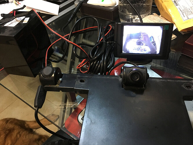

I have a project i want to do, I have a camera (its a camera from a car "backing-up" system, it would go behind the license plate and there is a 3" lcd that would go inside, it is from an Hopkins SmartHitch kit), i have connected it up to a battery (12V) for testing, and it works. I want to be able to connect it to a NodeMCU (or equivalent) to give it an IP address and basically make it an IP cam. The camera has four wires coming from it, RED/BLACK/YELLOW/WHITE the red and black are power/ground and the YELLOW is the video, don't know what the white is(audio?) using the same LCD screen and connecting the wires together then to the battery gives me a picture on the screen.

wvmarle - Thank you for your reply, ok thats kinda good news i think. I am getting the impression this might be a lot harder than I initially thought. Any tips on how to discover the signal type, I still have the original "board" that the camera and sensors were connected to, but no clue what i can do with it. I will attach a photo, not sure if it helps at all.
Irony aside, that is an ATMEL ATMEGA chip running it. I cannot make out which one though

@tinman13kup i looked with a light and magnifying glass, it says ATMEGAGA AU 1414.
@Grumpy_Mike - Cheers, not sure if it is the same camera, think i am going to have to open it up, but it is all weather sealed, thanks for the link.
I am assuming the pins (on the original board) could be used for connecting to the computer, would there be a way to connect it and see the program running on it, or even connect the board to the Nodemcu for the wifi, or am i just completely reaching now.... (if so, how to know what pins are what).
UPDATE: - After googling, i guess is says ATMEGA64, not ATMEGEGA.
