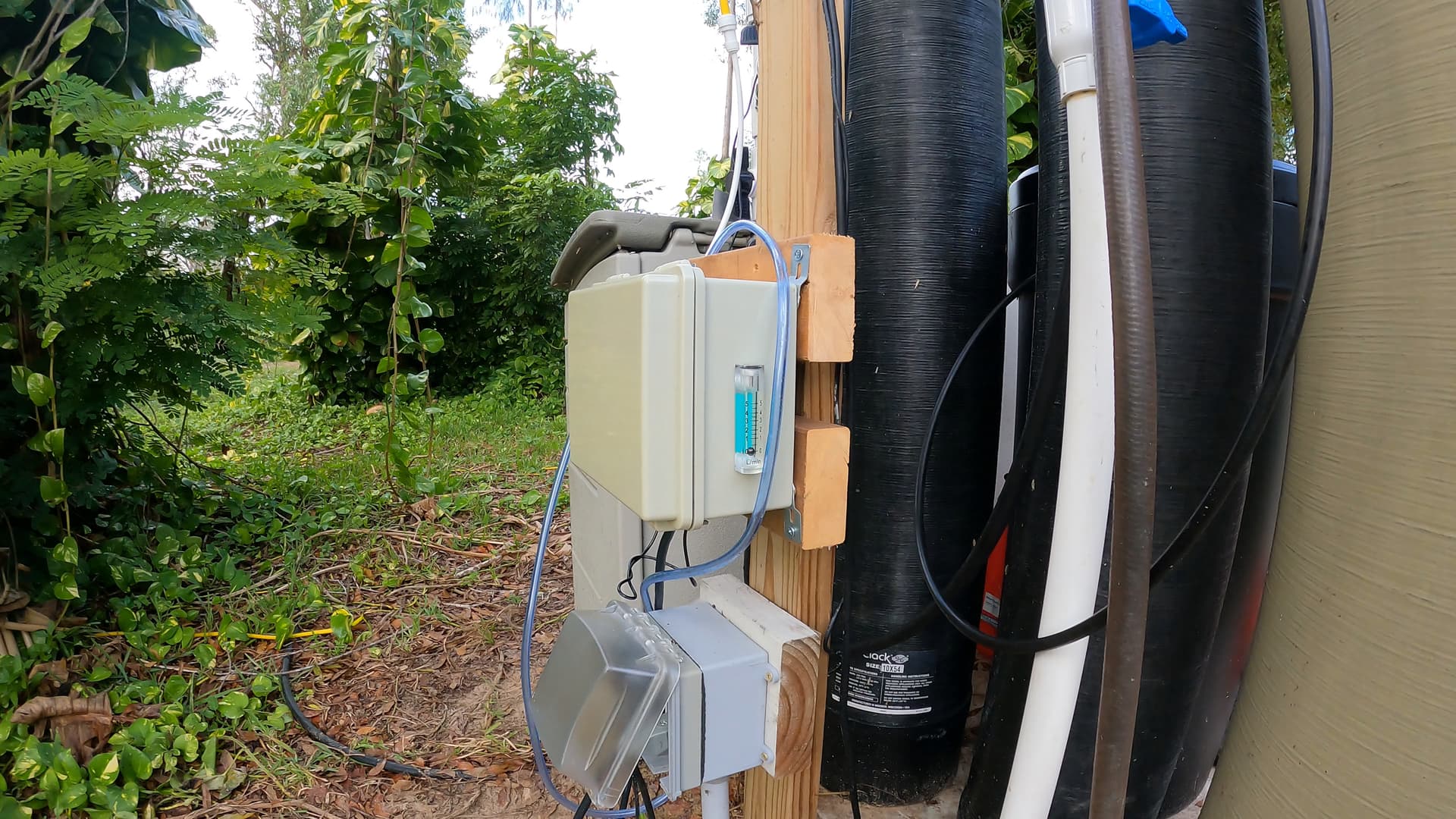

Hello, I would like to build a module that allows me to switch a relay using a camera. The switch would be triggered when the air flow rate is in the zone I want. The air flow rate is measured with a flow meter consisting of a small 5mm diameter ball bearing traveling up into a clear cylinder (floating ball design).
I need to trigger a switch when the ball bearing is in the right flow rate zone and for an x amount of time.

Why does it have to be tapered? The ball bearing moves freely up and down until it stops at both ends but let the flow pass it. I am adding pictures
OK, I went and tested with my gen1 night vision googles that are IR and I do see the ball bearing. If that is really a problem with the camera with the IR filter removed, I can use a source of white light (LED).

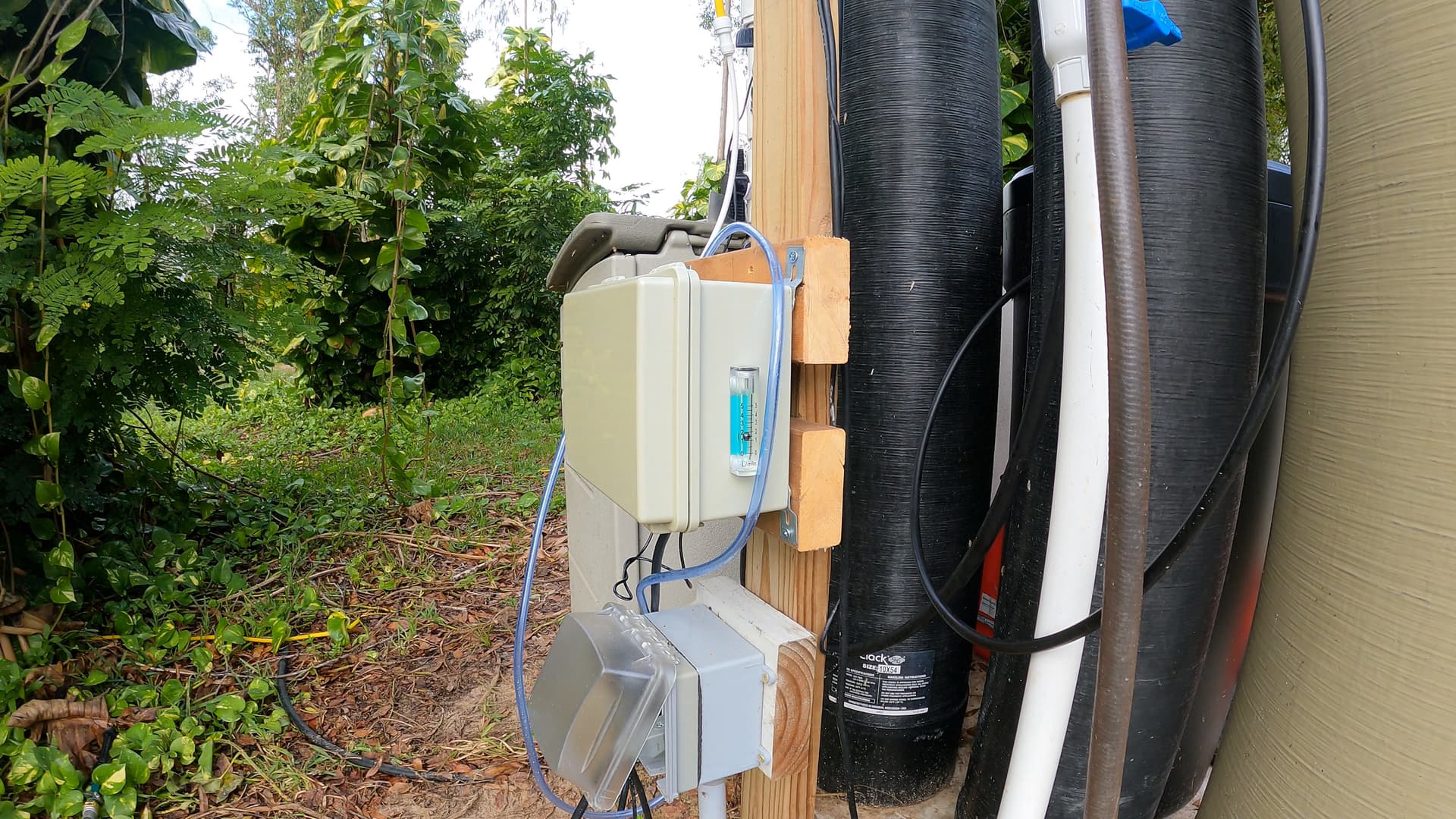

here are some pics of the flow meter with the ozone going through and without.
Hope this clarifies things.

The gauge bore is tapered, if it wasn't the ball would sit on the bottom until there was enough flow to overcome gravity, then it would shoot all the way to the top or bounce up and down.
