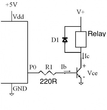

For the dry contact, an output on the NANO would connect to a base resistor connected to the base of a NPN BJT (2N2222).
5v to DPDT Relay coil, coil to NPN collector, emitter to GND.
place kickback diode across coil (example 1N4007).

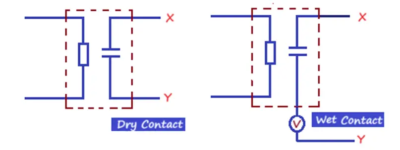

Perhaps it's not internationally known but certainly in the UK a 'dry' contact is one independent of other circuitry. In practice that means a relay or switch contact not connected to anything else, or possibly an optical isolator output not connected to anything else.
@georonn , you are correct, there is nothing on a Nano capable of providing a dry contact output. Simplest would be a relay module, of which many are available from both your favourite e commerce site or hobby electronics site.

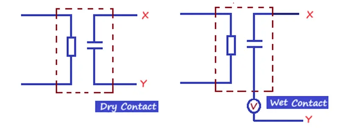

- In Canada, Dry is a simple contact (supplies no electron water stuff to a load).
Wet is a contact that switches a voltage, (supplies electron water to a load).
The circuit on the left will not cause that lightning and thunderstorm circuit to do anything; the one on the right will.
Actually it will work as the thunder circuit module that our dry contact is connected to detects the dry contact closure and proceeds to do its thing . . .
If the Arduino circuit wets the relay contact we call it a wet contact.
If the Load circuit wets the relay contact, we call the contact dry.

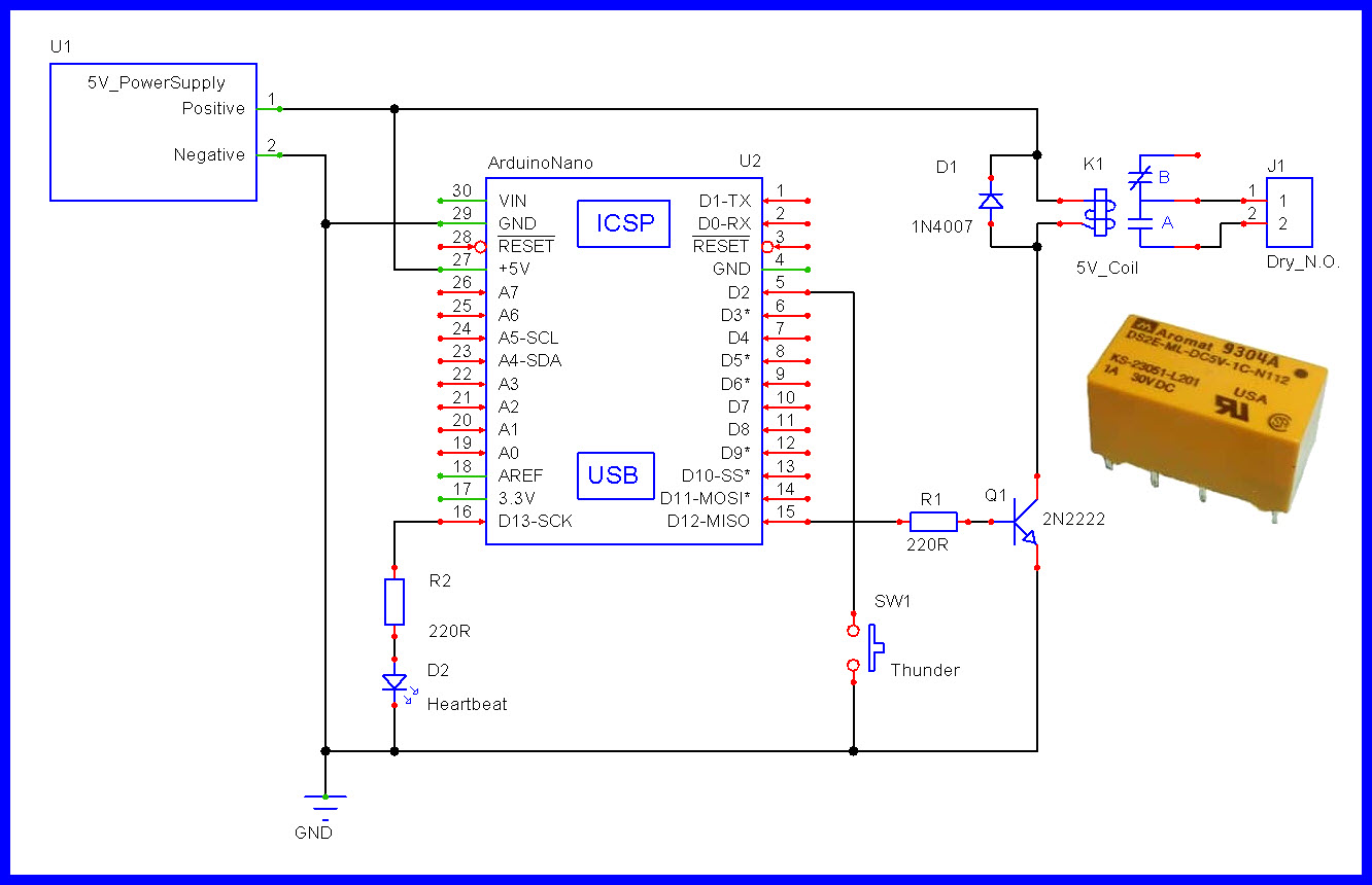

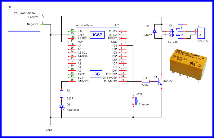

- This schematic and NANO C++ code should get you almost there.

Thanks, Larry, I think this circuit and the operational code you've provided will get me going toward solving this issue for the museum. Much appreciated.
George
