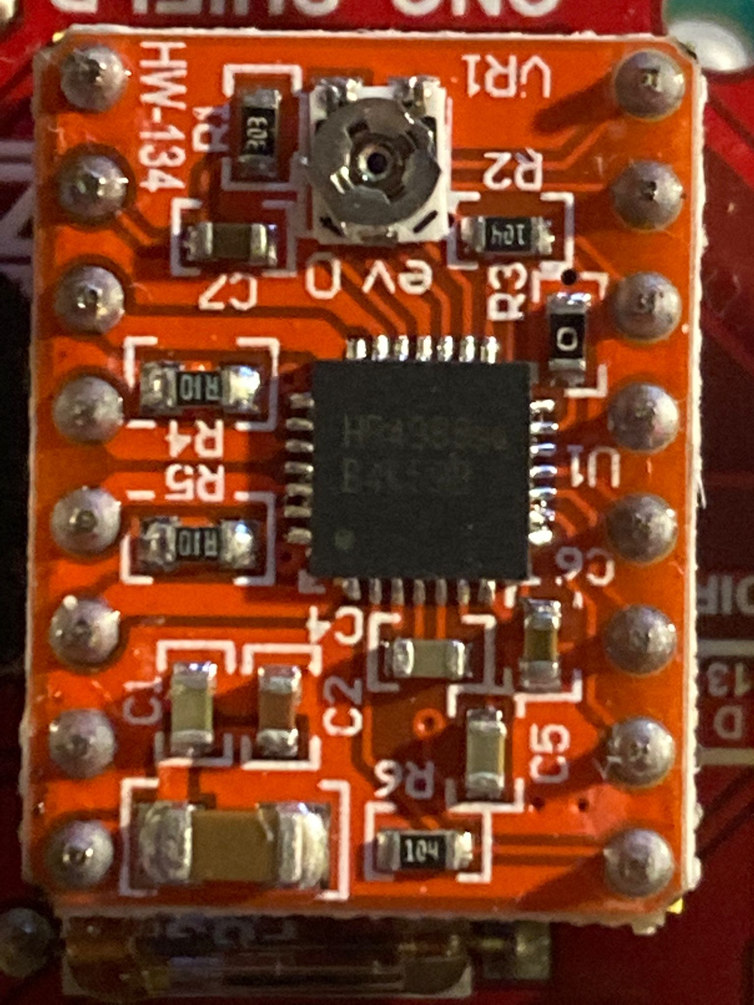

How is the motor coil current adjusted?
The coil current should be found in the motor data sheet. Set the current to less than or equal to the spec current. To set the current limit you will need to know the value of the sense resistor on the A4988 driver board. Then enter the value of the resistor and the required coil current into the formula Vref = Imot x 8 x Rsen where Imot = the coil current and Rsen = the value of the sense resistor. The Pololu A4988 page covers how to set the Vref but you must use the sense resistor value on YOUR board.
The yellow box shows the location of the sense resistors. Most of the Chinese clone A4988 drivers that I have seen have 0.1Ω (R100) sense resistors. Again, make sure that you know what the sense resistor values on your modules are before using the formula to calculate Vref.
Setting the coil current to less that the max is OK as long as the motor performs properly and does not miss steps. The motor and driver will run cooler and last longer.
is it possible that it is on the board R10? sorry for the large number of questions

Do you mean the resistor marking? If yes, I would expect that that means 0.1Ω. Like I said, 0.1Ω is the common value for current sense resistors on Chinese manufactured A4988 boards.

I'm just wondering what R10 means, how many ohms is that?
I am confident that those are 0.1 Ohm sense resistors.
probably some mistake in the manufacture of the resistor
I did a bit of checking and there are 3 digit SMD resistors and there are 4 digit SMD resistors.
R10 (3 digit) and R100 (4 digit) are both 0.1Ω.
ok, so i count with 0.1 ohm, thanks!
