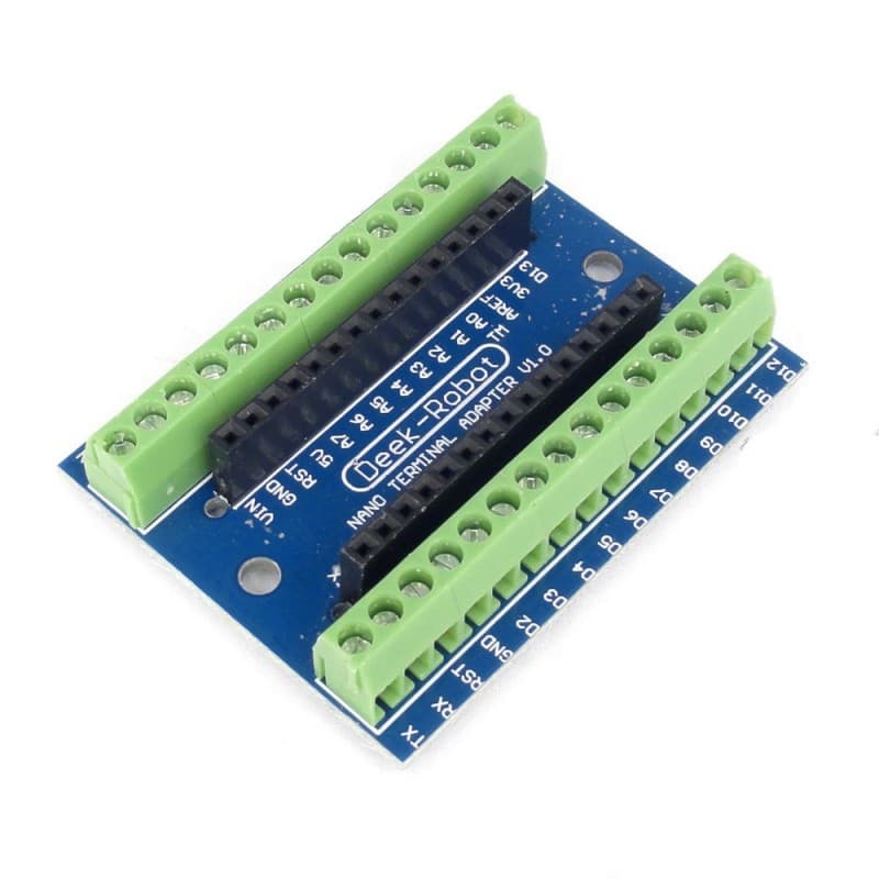

As to how you make the physical connection, if it is a permanent installation then using perf board is not overkill. Another possibility would be to use a carrier board like this one
The Nano plugs into it and connections to the Nano use screw terminals. This would allow more than one wire to be used in a single terminal
Thank you. What do you think of using something like this?

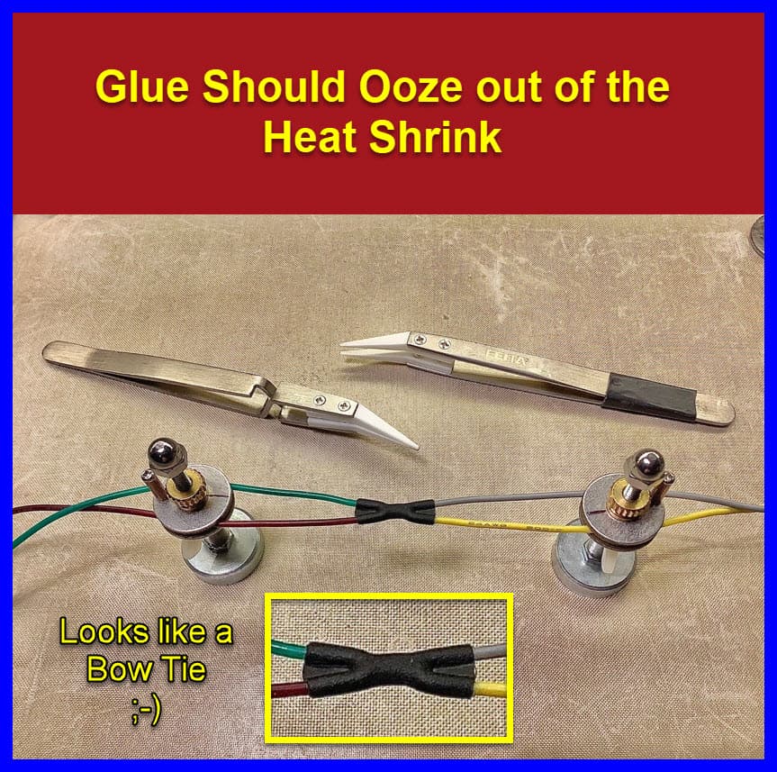

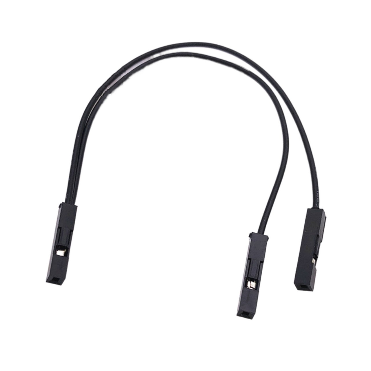

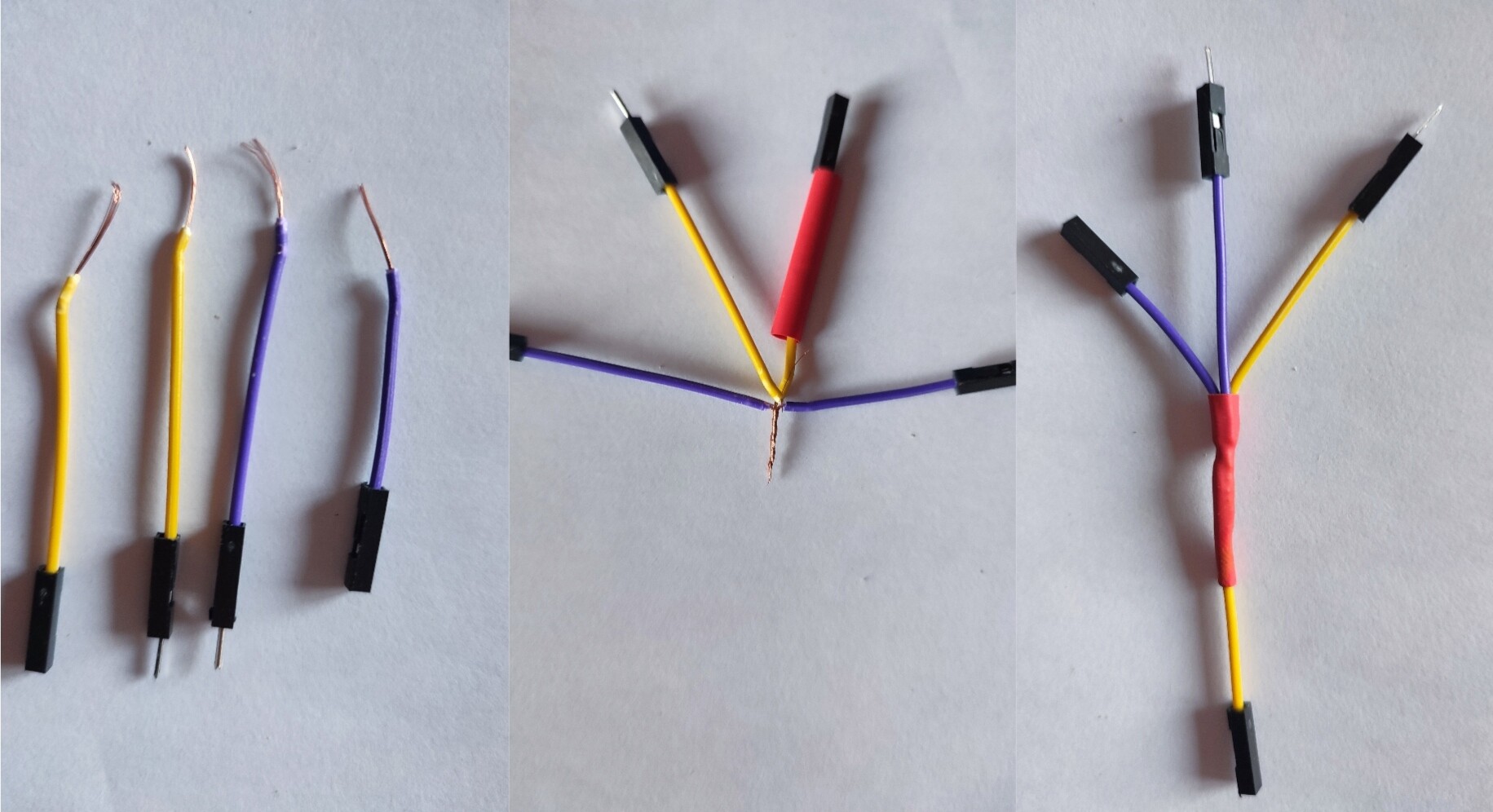

10 seconds jumper split.
Not for 150 amps though...

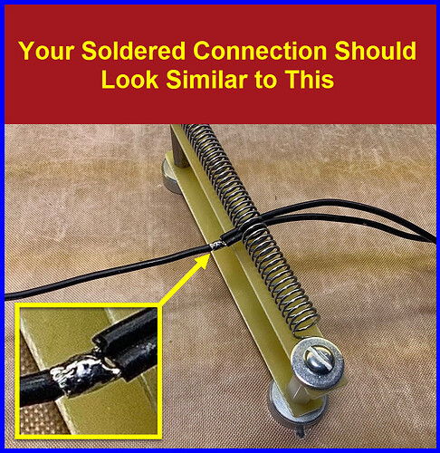

Or
4 Wire Cable.

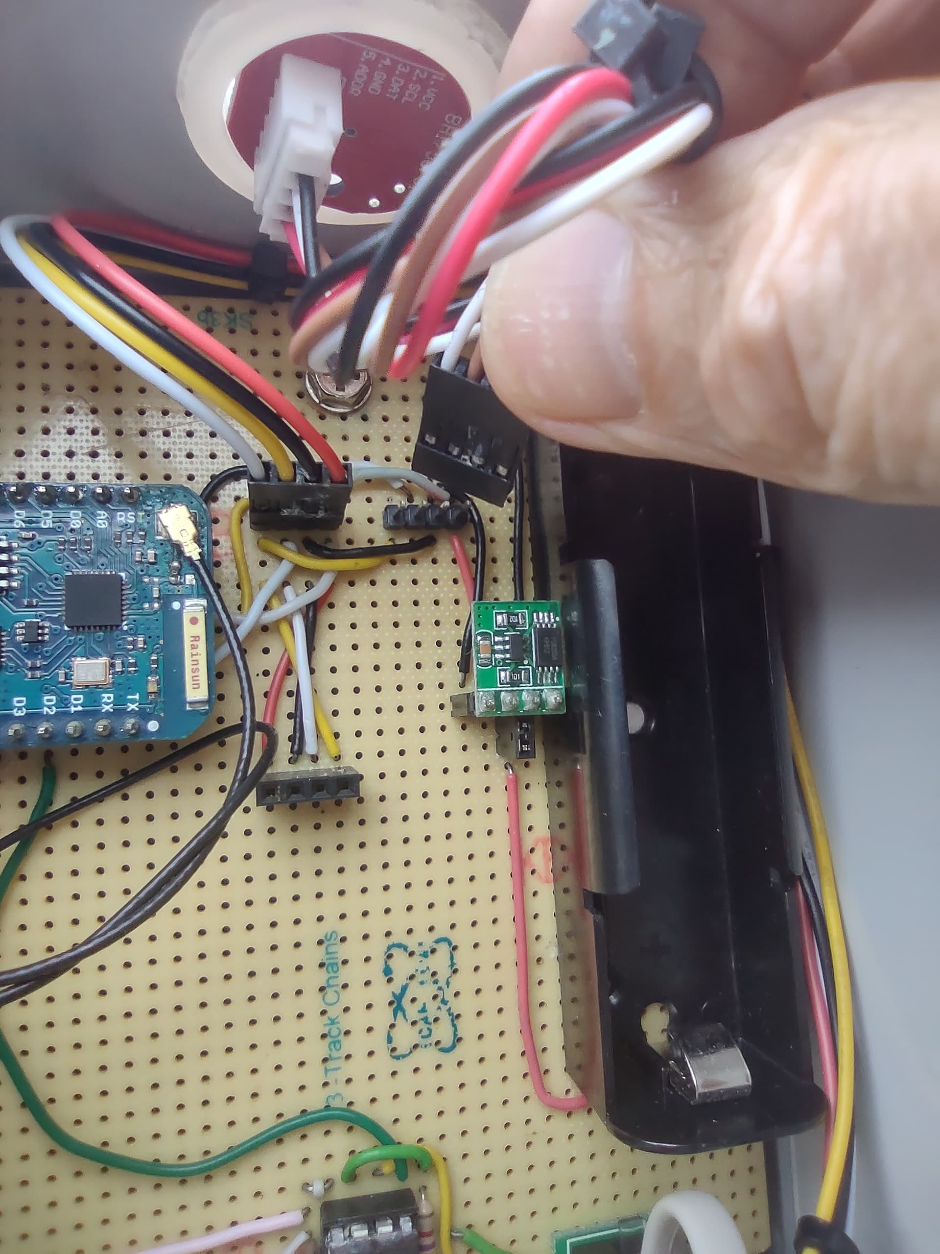

Sometimes it can be convenient for construction & installation and ease of replacement.

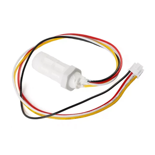

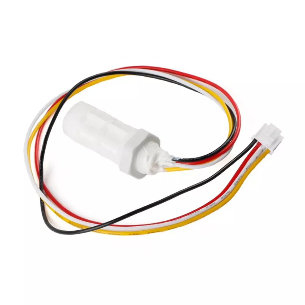

For example in my weather station, I used these sensors:
SHT30 Temp/Humidity sensor:

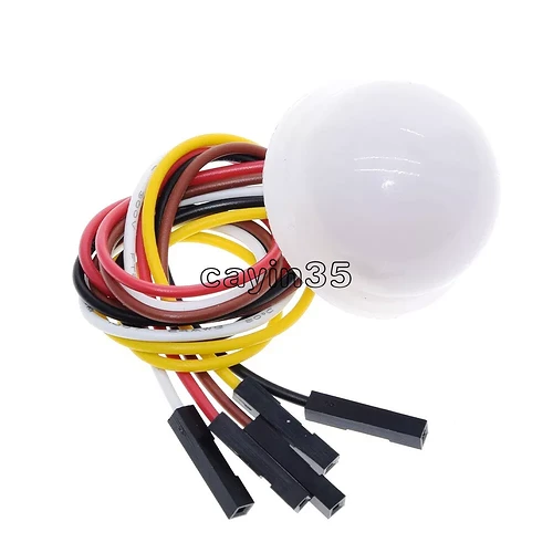

BH1750 light sensor:
With both sensors, I replaced the provided connectors with 4-way female crimp connectors. The sensors are mounted on the outside of the case.

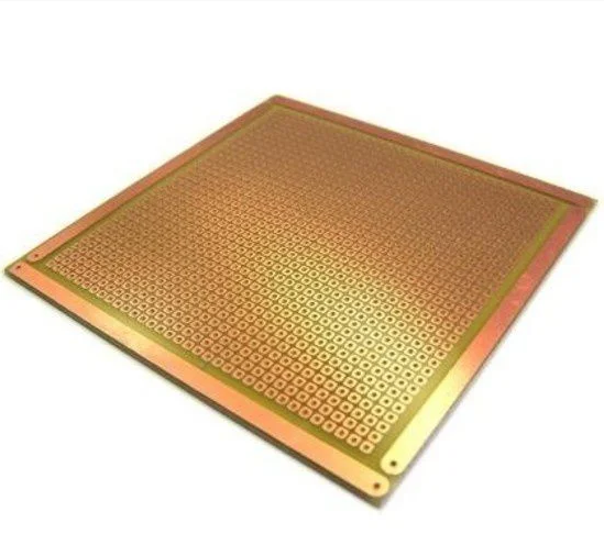

but the issue is that I'm looking at websites in my country, and I'm only finding for sales these stripboards (see image). As I understand it, they have holes that are isolated from each other, so I would still need to find a way of electrically connecting them, right?

Indeed you would, but
They are perfboards, not stripboards, there are no strips. And I can't believe stripboard is not available, in your country or any country. It's not exactly cutting edge technology! :slight_smile:
Maybe search for "Veroboard".
That's the time needed to make it.
Cut in half two jumper wires. twist them together and apply heat shrink for protection.
But what LarryD posted is more robust and elegant of course.
maybe because I'm searching in English, I don't even know what they are called in my native language. :sweat_smile:
  • some context helps
Which is?
In other words what is your native language?
Perfboard or stripboard are both prototyping boards. You just have to use some ingenuity to adapt them to your project.
Personally, I don't use perfboard much and mostly use stripboard. Both have advantages and disadvantages. One has isolated pads, so you make the connections, the other has the connections and you do the isolating by cutting the strips.
If you have a lot of SIL, DIL packages like CMOS DIP devices, then stripboard is easier.
I buy a large sheet of stripboard and chop it up into smaller, say 50-mm x 50-mm pieces. Cutting is by score and snap.
Perf or strip, look out for gold flash or tinned coatings to make soldering easier.
Some boards are designed for rack systems, Eurocards, 100-mm x 160-mm with headers to slot into a backplane.
For more finished projects, I use FR4 (fibreglass) boards with PTH (Plated Through Holes), which are sturdier, hold components better and allow some double sided work. Connections can be by deliberate solder bridging.
