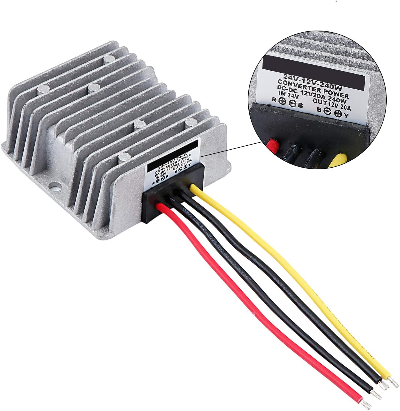

It would be better to use a DC-DC converter rated for the max current that could be drawn plus a generous safety margin.

12V linear actuators briefly draw the full stall current (7 to 10 Amperes) every time they start moving, so it is best to use a 12V power supply capable of handling more than that.
You can pick up 12V power bricks for next to nothing at thrift shops and computer recycling operations.
