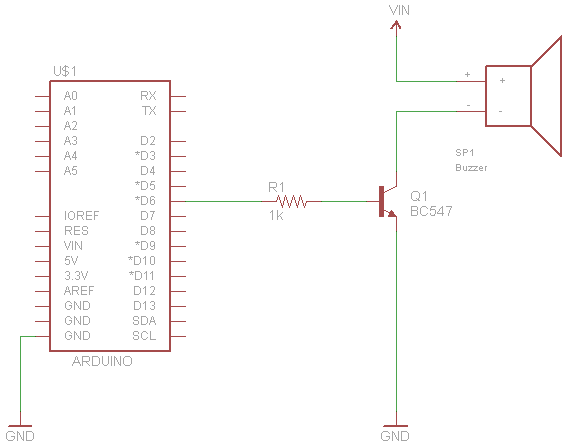

Bad idea. For one thing, the current quoted as 40 mA, though this is perhaps more likely to be what it draws at 15V than 5, is the average current and the impulse current will be much greater. If you then put a much larger capacitor across it to average out the current, the initial charging current of that capacitor will be much greater still. You would probably get away with it, but if you want reliability, no.
Just use a common transistor - BC547 - in the ground leg to switch it, and a 1k resistor to drive the base of that transistor from the Arduino. You will lose a couple of hundred millivolts, but you would lose much the same with most "logic" FETs. However, if you use a transistor to switch it, you can connect the positive to your "Vin" voltage, probably 9 or 12V.

And here because I'm bored and like playing with Eagle CAD is a circuit....
