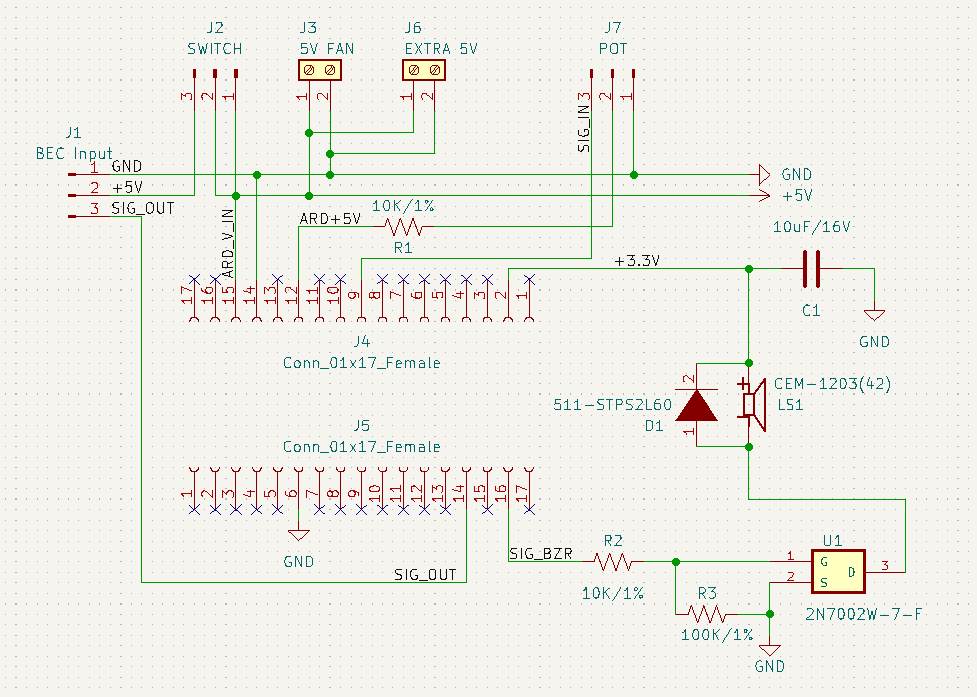

Hi there. I'm making a circuit described by the schematic below. It is worth noting that the circuit worked fine prior to adding the parts associated with the CEM-1203(42) piezo buzzer. The only difference from the schematic and the stuffed PCB I have is that I'm using a 10 uF/50V electrolytic capacitor instead of a 10 uF/16V.
When I plugged in the micro for the first time and uploaded the code, it uploaded fine, but the program would not run (evident by the fact that the programmed sound would not play). After the initial upload, my computer (MacOS) would no longer detect the micro on the USB ports, so I am unable to upload to the board anymore.
Link: Schematic Image [Imgur]
Notes:
  • The net +3.3V is connected to the 3.3V power pin of the Arduino micro
  • The net SIG_BZR is connected to digital PWM pin 11 of the Arduino Micro
I uploaded the code on a second arduino micro, and the issue did not present itself. I could upload as much as I want and as long as it wasn't placed into the PCB my computer would continue to detect it via USB. As soon as I uploaded the code to the new micro while on the PCB, the same thing happened. The USB is briefly detected, for about 1 second, and then becomes unrecognizable by the computer. If I unplug the USB and plug it back into the micro, it again recognizes it for one second before it disappears again.
I suspect the circuit is designed poorly on my part. I'd like to know what the likely cause is and how to correct it.
I appreciate any help y'all can provide.
The CEM-1203 buzzer is electromagnetic and cannot be powered from a port pin.
Please post the schematic in line, or attach it to your post.

It looks OK, however R3 should be connected to SIG_BZR, not the gate. Also, I would add a 33R resistor between the 3.3V pin and C1/buzzer to further reduce buzzer-induced electrical noise in the 3.3V rail. Remove the MCU, activate the buzzer, and use a scope to examine noise in the 3.3V rail.
If the PCB is correct, you should look for other possible causes for the failure.
EDIT: the buzzer coil resistance is ~42R, which means it will draw 78 mA from a 3.3V supply. Have you verified that the 3.3V output can safely provide this much current?

Maybe. It can provide more current, usually. Why are you convinced that the buzzer must run on 3.3V? Thus, that you must use a regulator?
If the board has problems when it boots, if the buzzer circuit is not active (i.e. the 2N700x transistor is turned off), then there is some flaw in the wiring or an incorrect component. Because, the schematic looks fine, at least as far as that is concerned.
Again, if you have problems before even activating the buzzer, then the problem is not the buzzer load or supply at all. It's more likely in the buzzer drive circuit.
Is SIG_BZR configured and set low at boot time? Have you measured any voltage levels around the drive circuit with a DMM? That would be the textbook troubleshooting step.
I doubt it. I suspect you will find that there is some difference that is causing your problem.
Buzzer rated for 3.5 volts. Drive it with NPN transistor, or Mosfet. But yes, you'll need to beef up your 3.3V power, or maybe drive the buzzer with a suitable resistor between it and the 5V source. The buzzer draws 35 ma, you want to drop 1.7 volts, sounds like around 50 ohms would do it.

The buzzer is just a coil, with the previously mentioned DC resistance of about 42 Ohms. The buzzer power supply must be capable of handling much more than the steady state current draw of 78 mA at 3.3V, and must be well decoupled from the MCU power supply.
What signal are you using to drive it?
I like that.
Leave the electrolytic cap where it is, buzzer (+) to ground, but place the 50 ohm resistor between that junction, and 5V.
There will be a "chirp" of a few cycles when it turns on, but nobody will be able to hear it, and it won't exceed the max voltage rating of the buzzer, 5.0V.
It will save you the cost and complexity hit from using a 3.3V regulator. The cap and feed resistor will help isolate the buzzer EMI from the rest of the circuit.

@jremington You're recommending to not use the 3.3V Arduino pin at all, but @camsysca is saying it's okay as long as it's inline with a current limiting resistor. Can either of you elaborate on why one approach is "better" than the other, if at all?
Use of an appropriate current limiting resistor solves the problem of drawing too much current from the 3.3V output.
...or drawing too much current from the 5V output if that is what you use for the supply... I don't believe that the buzzer absolutely demands a 3V supply... it's designed for it, but it is the current that really matters. You can derive the correct current from any voltage supply. The 3.5V rating of the buzzer expresses the right supply voltage when no current limiting resistor or circuit is used.
The 3.3V supply of many Arduinos is very weak in delivering current. So it's best to just avoid using it for anything power-hungry if you can.

Then, you are chasing the wrong problem. None of the buzzer circuits we are discussing should do that. You posted a layout and that is great, but the problem could also be in the component selection or a difficult to see flaw like a solder short.
Also you need to get in there with a DMM and report back to us the findings.
Edit- why is there a 10k resistor in series with the MOSFET gate drive? That will increase the power dissipation due to slower switching.
So just to hammer in a point, rarely are such potential flaws solved by inspection. You have to do some step by step confirmation of all the traces, for continuity and also for unintended shorts using a DMM as well as visual inspection. Sometimes the measured voltages can provide a clue, even when the device won't work.
Sometimes it's a component issue, for example the pin out or polarity of some part is not what you expected. Welcome to the fast lane.

Edit: I've tried to round up the suggestions for altering the buzzer circuit thus far into the schematic below. Is what I have correct? The Vgs threshold for the mosfet is only 1V, but the PWM output is 5V - should I not include a voltage divider?
I was about to say that the capacitor is unnecessary, but it may actually be advantageous in isolating the pulsatile current from the buzzer from the rest of the circuit. Its connections to the buzzer and the FET ground must be as short as possible. 100 µF better. :+1:
What it will do is to charge to 5 V when the FET is off so that when it turns on, the buzzer will initially be powered with the full 5 V, however for an electromechanical buzzer this will not be harmful.
You should not.
