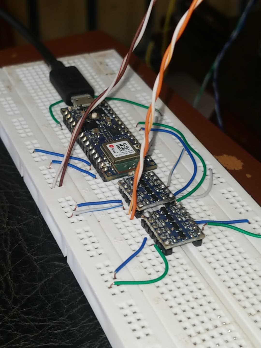

I will try shifting just the data line to see if HX711 will accept 3.3v clock logic in a couple hours (away from my desk ATM).
Howdy folks. Got round to testing with only DT going through the logic converter. Worked splendidly on the first try. Big thanks to Leo and Jremington.

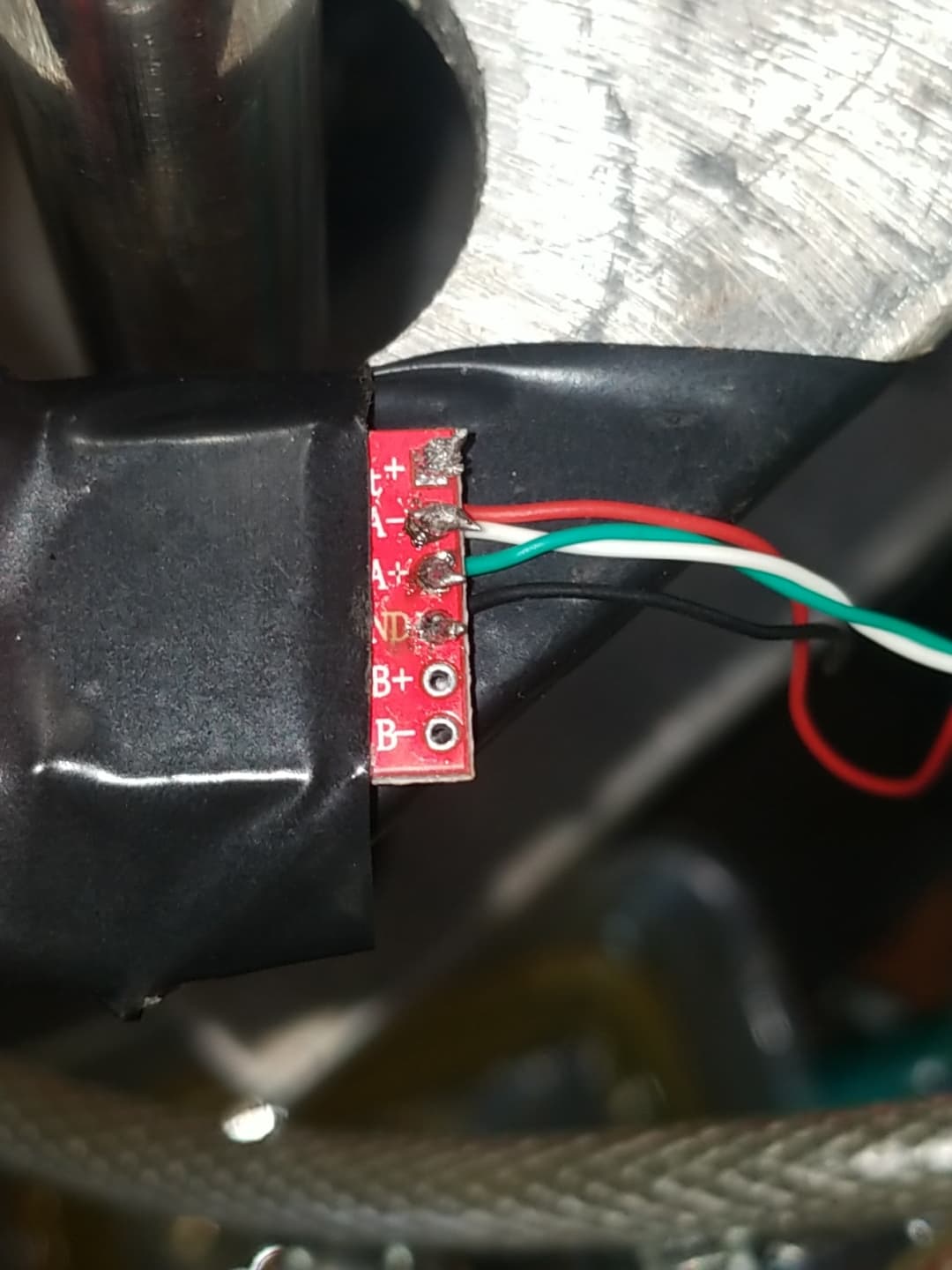

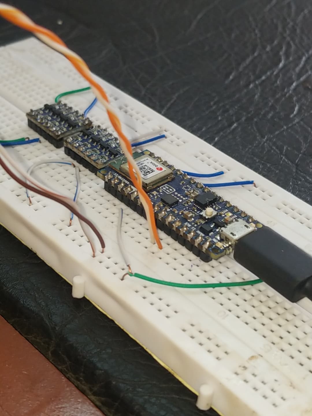

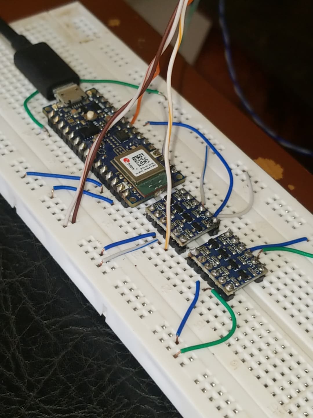

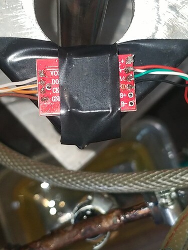

Added a few pics of my setup. My soldering skills aren't spectacular but nothing seems to shake if I pull at the wires lightly.
Image 1: wired HX711 module
Image 2: closeup shot of breadboard side wires
Image 3: closeup shot of load cell side wires
Image 4: working 3.3v breadboard setup
Image 5: nonfunctioning 5v breadboard setup
Image 6: functional 5v breadboard setup
It seems strange that running SCK through the shifter throws up the error. One would expect that to be the standard way of wiring the module to the nano (33 BLE). Any thoughts on what might be happening there?

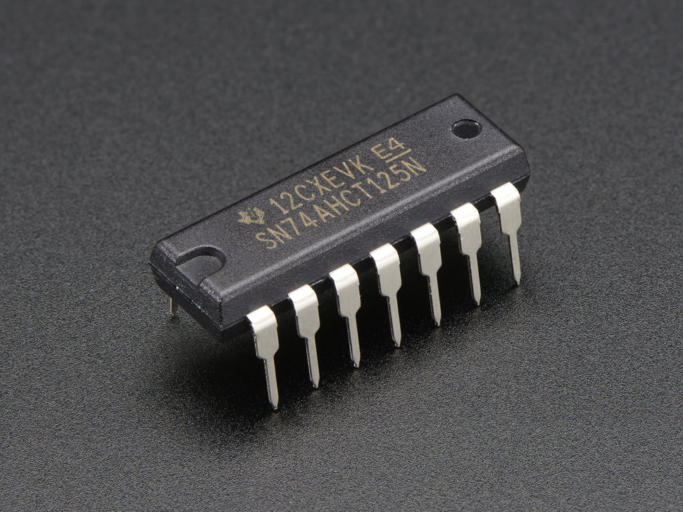

Those level shifters are designed for I2C, which is passive pull up and active pull down.
To level shift a digital push/pull signal, you should use digital ports, like this one.
Can you still try the 1k:2k (2k2) voltage divider I mentioned, no level shift boards.

OTOH, your last reply's got me studying up on level shifters generally. I think the answer to my SCK question is related to how they work.
Tried the 1k:2k voltage divider and it worked fine (no suprises there).
I suppose it's more efficient compared to using level shifters cos there are fewer components and smaller resistances involved, hence less power draw. Thanks for the tip Leo.
Comes in smaller foot prints too.
Yeah, Leo mentioned that one a few posts up.
Basically, HX711 SCK port is not compatible with level shifter conversion techniques. Use a digital port instead. However, SCK port accepts 3.3v straight from 3.3v MCU so digital port is not strictly necessary.
