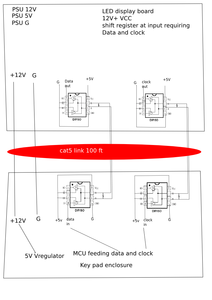

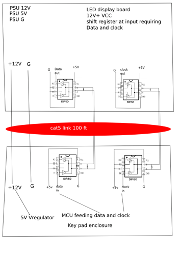

Here is the over all use for the board. I still need to test and draw up the voltage regulator part of it. I also need to finalize what I want to be optional. I am thinking I may have to draw it out.
So you can make a single board with a few jumpers to do both ends eh?

Yes one board that can do each end. I also do some DMX stuff and this would work for that as well!

This board allows me to send some signals (in this case clock and data to an LED display) long distances and to multiple locations. I am also sending 12V power down the wire as well.
The IO pins on the Arduino and other logic chips are only made to drive signals a few inches on a circuit board. The max485 chip we are using here can take those signals and convert them to an RS485 hardware layer. RS485 is good for several thousand feet and driving 30+ slave units. You can read more about RS485 on wiki and a few other pages, it has been around for a VERY long time.
I also added a 5V regulator so I can power the max485 chips and some external devices I use that are 5V only. If you have any more questions just ask.

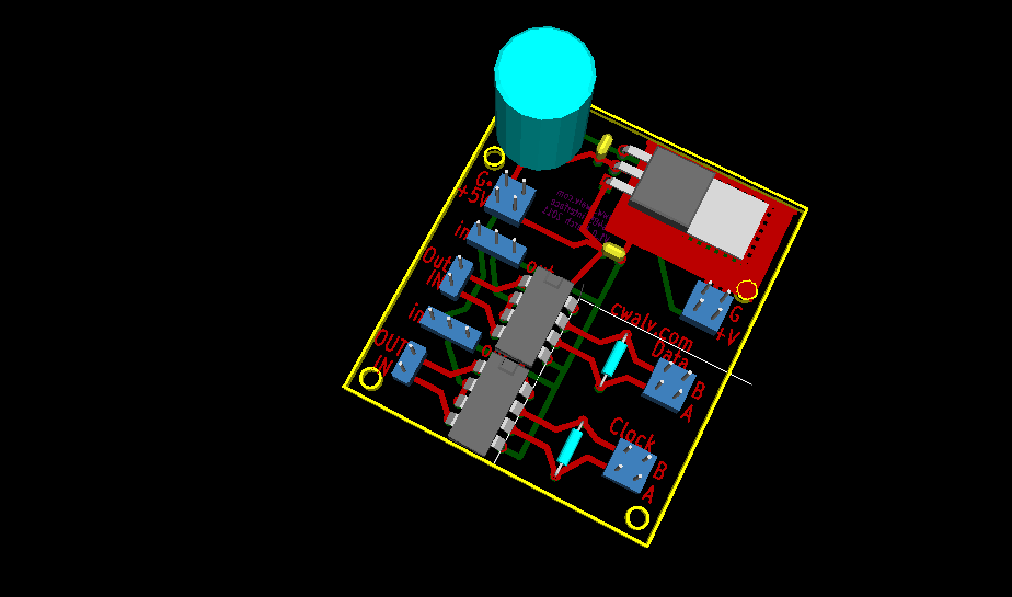

Here is a rendering of the finished board.
The layout looks good. I think your 22uF cap model may be a little too big. Compare that to this 100uF, 16V cap which can be seen to be about 0.15" wide, versus what looks like twice that.
5mm actually, just measured it.
Thank you. I am a little bit confused on the capacitor size.
The data sheet says .22uf for in and .1uf for out. However the normal values I see on line are 100uf in and 10uf out.
Here is an updated version that would let me use ether or both size capacitors.
I have looked at many manufacturs data sheets for 7805s, and all show 0.33uF on input & 0.1 on the outout. Bigger will not hurt. The physical size of the parts will vary. I just finished making 12 boxes, half had 12V sourced over 40-50 foot cable. I used 1uF on the input and 0.47uF on the output, that's what I had on hand, worked just fine. Neither were physically big as the your model has. If the board can take a large part like that, than a smaller part would certainly fit.
