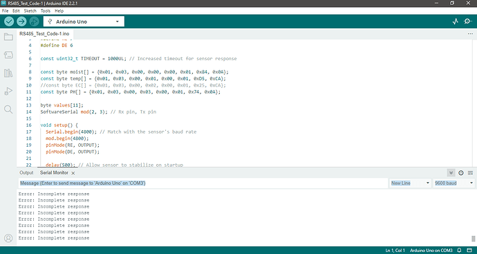

Can someone help me, for my 4in1 5pin probe RS485 THPH+EC Sensor, I have code but it doesn't read anything. I am using arduino uno for this

They did not come from your code in post #1. The image in post #2 came from the code in Post #1.

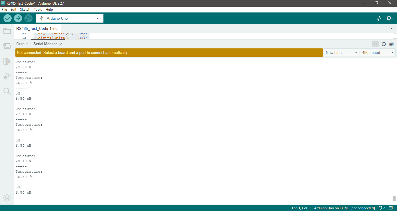

yes sir, about on the first attempt on post #1, i just replace my 9v battery for the power source of my sensor with another 9v then i try to run and upload it, the outcome on serial monitor becomes like that on my post (screenshot) that has hex values on the output
and i noticed that the readings from every parameter are inaccurate for an instance the ph level, it gives me 5.90 even if i didn't put in a soil, but once i put it on the soil its not changing it stays on 5.90
Replacing your battery changed the output from 0.0 to 01 03 02 01 B5 78 63?
You code in Post #1 is not complete... correct it. The reason I did not see any of your hex values is that your code stopped here:

Now I see the issue. See the word HEX (twice)? Change that to DEC (twice).

This bad data is standard for this device. Inaccurate or completely fake. See what you can do to your code to adjust your results. If you use distilled water, you should adjust your code to get a pH 7. You can make your own distilled water by boiling water and collecting the steam on a cold surface, letting the steam condense and run down the surface into a jar.
i think i already figure it out

Hello it's me again, I have a problem about this RS485 sensor, can someone help. I already make it work but, this time it always gives me a same output for different parameters. I already put it in a soil, dry and wet, but still giving me a static output. What should be the solution for this?
You seem to expect that we can look into your room. How should anybody know what the reason for the obeserved behaviour of constant values will be without giving detailed information?

even in serial monitor, it prints "Error: Incomplete Response"
Have you compared your vcery large sketch to any of the hundreds of examples doing the same thing?
There might be a reason why those that work are smaller.
I already did sir
can someone help :<
It's written on your code..
If there is no valid byte, it gives -1 and the sensor output is multiplying that *0.1.
How is your hardware/wiring?
You haven't provided any details about your sensor.
Is it this sensor?
If yes dfrobot has a demo-code on this side.
Where did you buy this sensor? Does the seller provide links to demo-codes?
Perhaps you should read the topic here, it is the same code as yours.
That's a clue for you. Have a look in the code you posted (which looks like it was adapted from a piece of demo code I posted on the forums quite a while back) for where that message is and what causes it to be printed out.
Then you can insert some debug print statements to see what's occurring.
I'll make a wild guess that the value of byteCount is 0. If I'm right, then see if you can figure out what that means.
You should also provide a drawing (as already requested) of how you have connected the various parts of your project together as that may also hold a clue.
