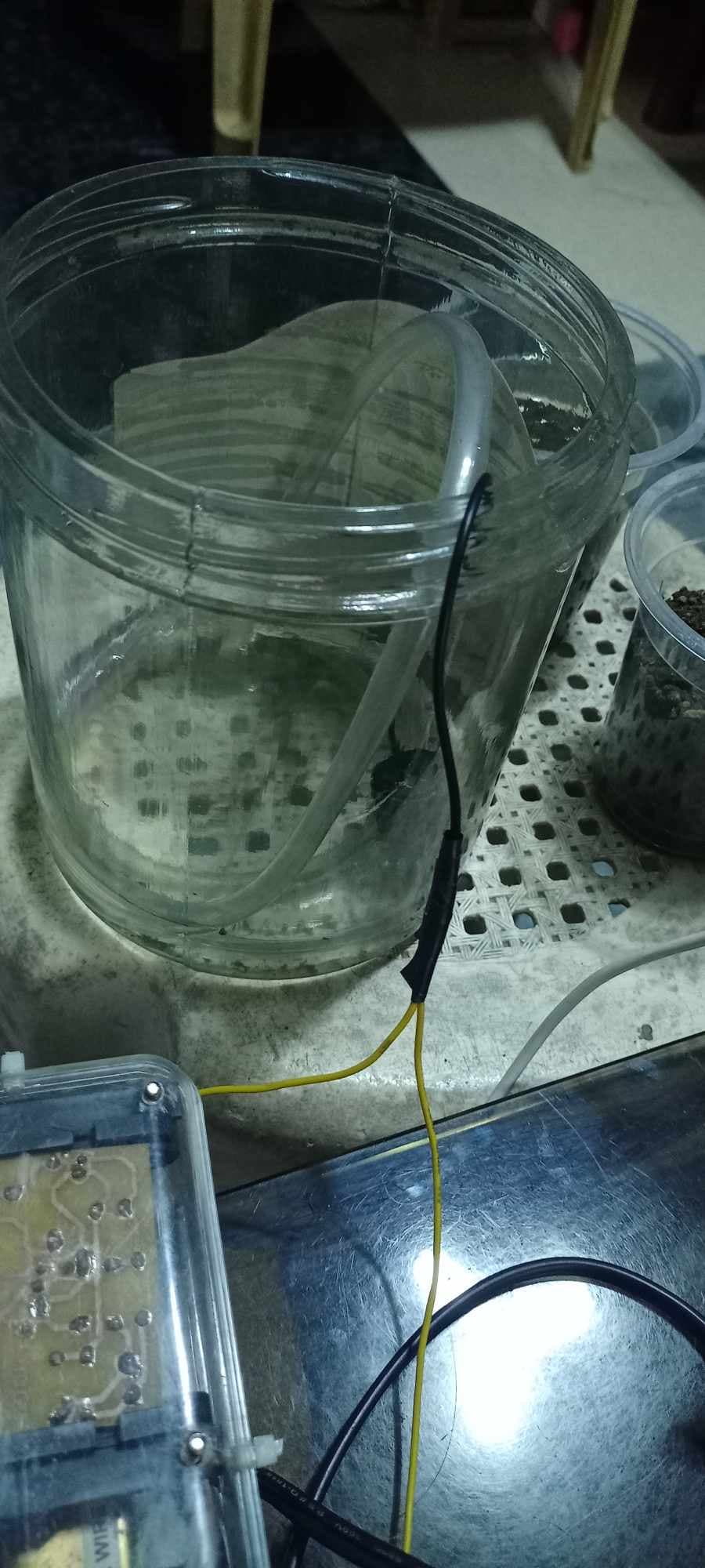

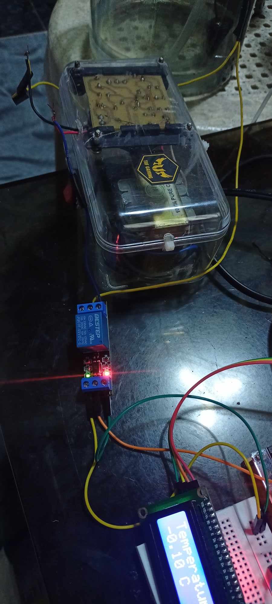

post a real picture of your hardware. Some breadboards have a gap in the middle of the power-rails. This means if you connect power on one end of these power-rails and want to supply something on the opposite end no power is delivered caused by the gap.
an arduino-uno-board is NOT a power-supply. Trying to supply a relay from the 5V pin of the arduino is bad idea.
You should really post a picture of your hardware setup.

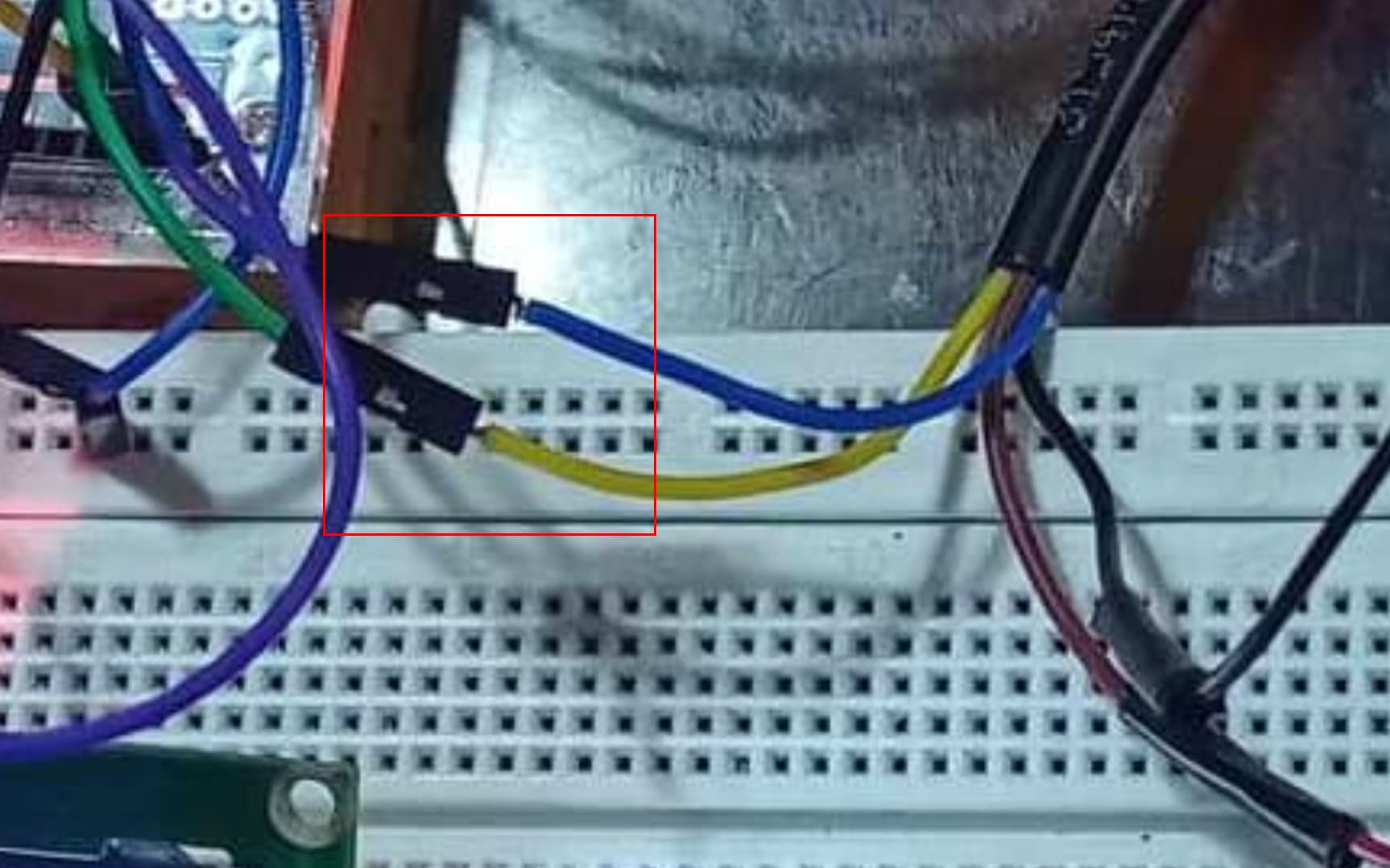

These two connections look not very reliable
im struggling to wire that because of the default wires from the sensor. I just think to connect it on a jumper wire, since was able to provide accurate readings before.
The other two wires seems to be soldered to a jumperwire and then isolated with shrink-tube.
Can you do that for the yellow and blue wire too?

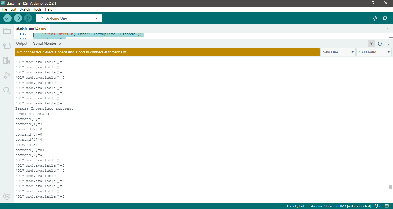

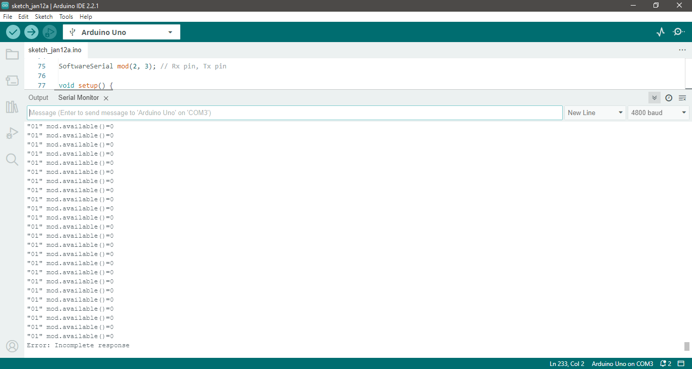

Here is a code-version with additional debug-macros and additional serial printing of the bytes that you send towards the sensor and the bytes you receive from the sensor.
This will help analyse what is going on

  Serial.println("sending command[");
  for (byte i = 0; i < 8; i++) {
    // print each and every byte that is sent
    Serial.print("command[");
    Serial.print(i);
    Serial.print("]=");
    Serial.println(command[i], HEX);
  mod.write(command, 8); // Send command (8 bytes)
  mod.flush();
  digitalWrite(DE, LOW);
  digitalWrite(RE, LOW);
  delay(100); // added this delay to give the sensor time to send his answer
  startTime = millis();
  while (millis() - startTime <= TIMEOUT) {
    // print number of bytes received
    dbg("01", mod.available());
    if (mod.available() && byteCount < sizeof(values)) {
      values[byteCount] = mod.read();
      // print each and every received byte
      Serial.print("values[");
      Serial.print(byteCount);
      Serial.print("]=");
      Serial.println(values[byteCount], HEX);
      byteCount++;
  // Check if response is valid
  if (byteCount < 7) {
    Serial.println("Error: Incomplete response");
    return -1;

you have written that you are powering the
  • LCD-display
  • relay
  • RS485-module
all from the 5V-pin of the Arduino.

This is what i get from the serial monitor sir
I have to ask back if this is that part of the serial output direct after start or maybe 30 seconds after upload?
The more interesting part is where the sended bytes can be seen
yes sir, but i tried to change the source of it before even the sensor itself, it gives me the same outpu
yes sir
what source? What do you mean?

the source of the rs485 sensor since i thought 9v batt is not enough i try to change it into 12v, then the 9v to relay, and lcd. Still nothing happens
Is LCD still working?
because most of these LCD can stand only 5V
You should not power it by more than 5V

is this the bytes you are talking to sir ?
