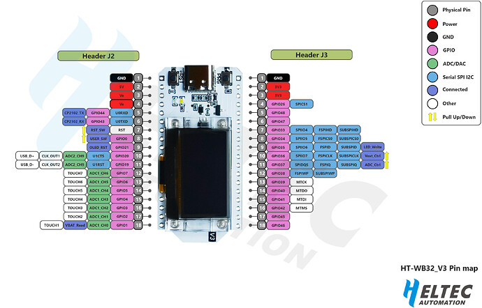

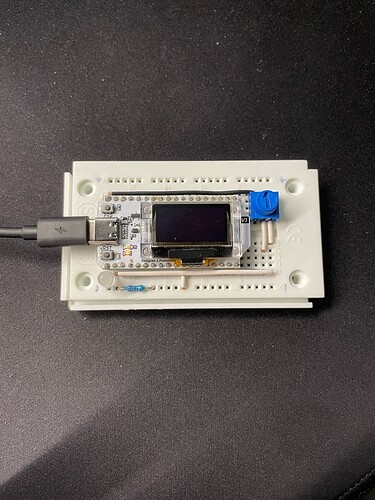

Hey guys, so thanks for helping, I am still a beginner an appreciate your help. There are two pictures where you can see the wiring. There is also a pinout of my esp32
So I changed the code a little:
  • I removed the #defines and wrote the pins directly in the code
  • I added the g_OLED.display
  • I changed the poti pin to 4 instead of 1
It wont work anyway, please send help....

Heltec WiFi Kit 32 (V3) : https://heltec.org/project/wifi-kit-32-v3/
According to its schematic, the OLED is connected like this:
OLED SDA = ESP32 GPIO17
OLED SCL = ESP32 GPIO18
OLED RESET = ESP32 GPIO21
The "GPIO17" is "17" in the Arduino sketch.
#define OLED_CLOCK 17
#define OLED_DATA 18
#define OLED_RESET 21

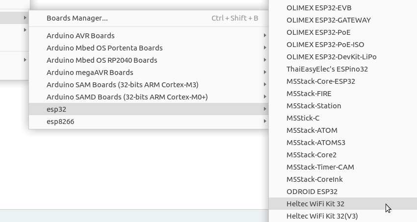

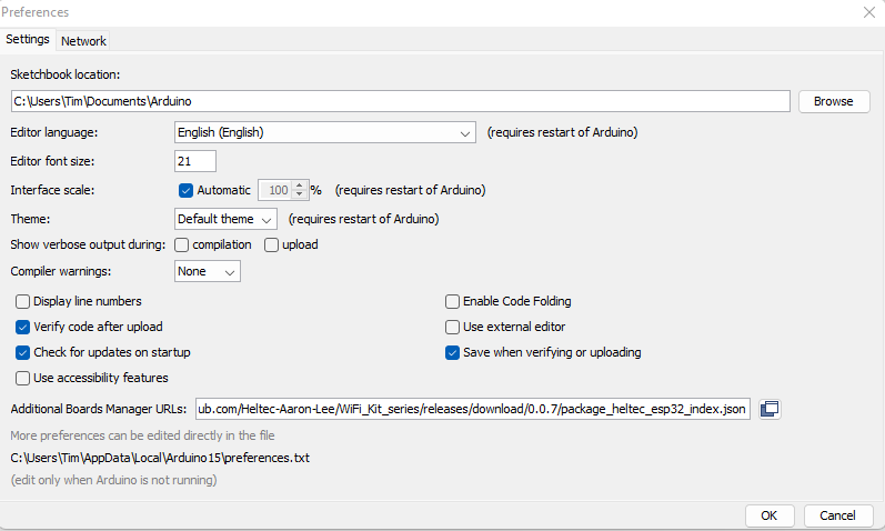

Thanks for your answer, so arccording to several YT videos you need to include this URL in the Software (see picture below). Without it it wont work, but in the Online version of arduino there is no option to do that, but i need the online version because i want to control the led via IOT Cloud.
You can see the URL i added at the additional boards manager URLs

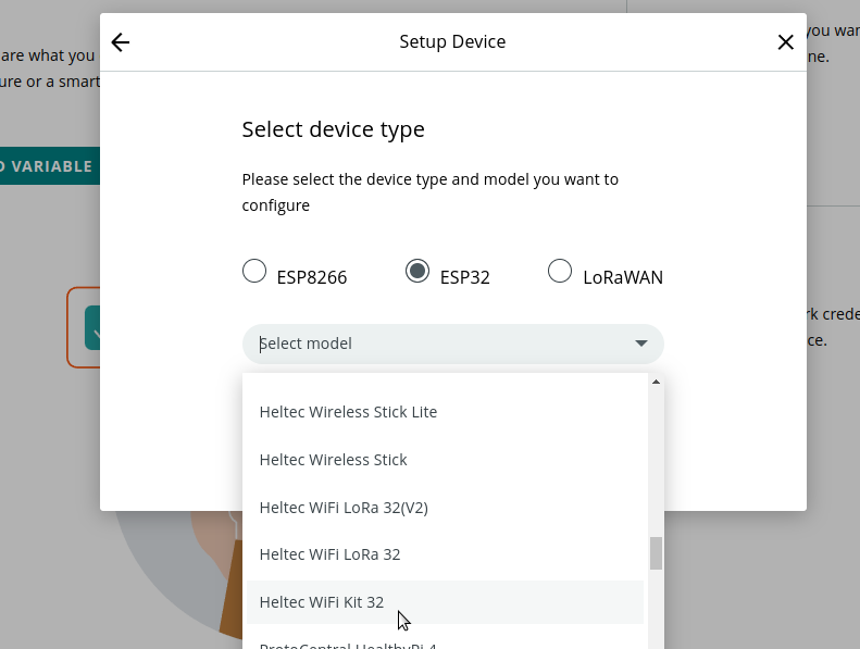

The Arduino IoT Cloud is for Arduino boards with Wifi, and no "json" URL for additional boards can be added. But it also works for the ESP8266 and ESP32.
Do you have a ESP32-S3 ? That is not a ESP32, but it is part of the ESP32 build environment.
In the Arduino IoT Cloud, I can select non-Arduino boards and there is your board:
I suggest to remove the special "json" URL for additional boards in the Arduino IDE from Heltec. It is probably an older version of the ESP32 build environment. Use the common ESP32 "json" URL for the newest version (https://raw.githubusercontent.com/espressif/arduino-esp32/gh-pages/package_esp32_index.json) and your board is there are well:
Thanks, but i already tried it, when i select the heltec wifi kit 32 it wont work, it says wrong chip (because i have the v3 version of the board). So i have to use the esp32v3 model and then it works.
In the Arduino IDE i change the URL and it works, thanks but i want to make it work in the online arduino ide, and i want to make the heltec library work or use the u8g2 lib for the display on my board
Here is the error code when uploading with the heltec wifi kit 32 selected
So the first version of the Heltext Wifi Kit 32 uses a ESP32 and they changed to ESP32-S3 for the "V3" version. Then you are out of luck for the Cloud IoT :cry:
I assume that it will be added someday.

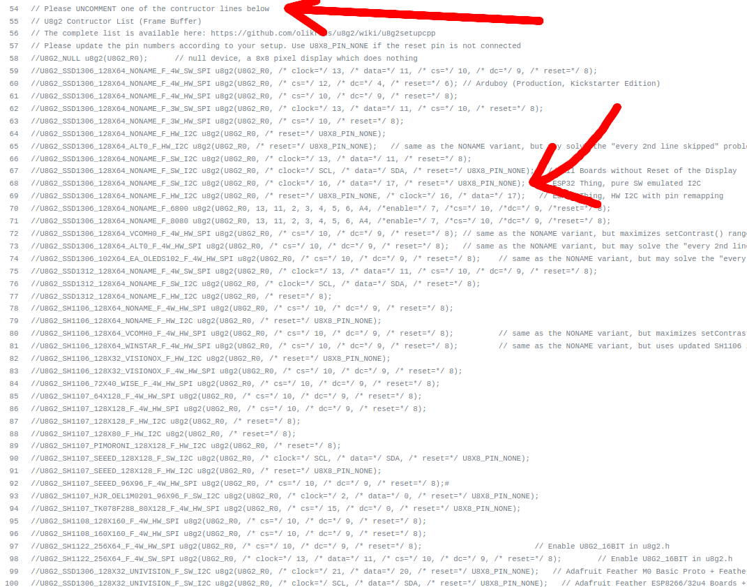

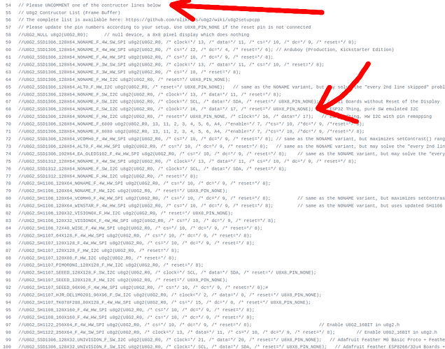

Yea but do you know why my boards doesnt work with the ssd1306 example in the arduino ide, i just tried it and it wont show anything.....

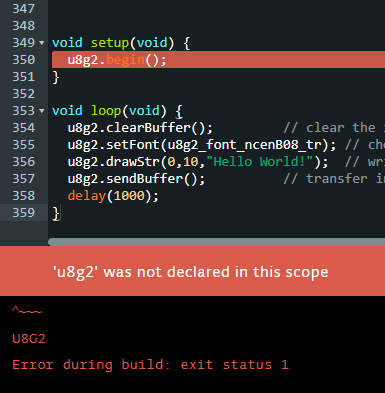

Can you try the "Hello World" example: https://github.com/olikraus/u8g2/blob/master/sys/arduino/u8g2_full_buffer/HelloWorld/HelloWorld.ino
Show the sketch that you used for the test.
Hey, so i tried the u8g2 hello world example you sent me.
It doesnt work, here is the error code:

In case you don't know the u8g2 library, I wrote: "Show the sketch that you used for the test".
Because you have to select the bus, the mode and the pins.
