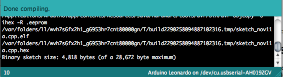

Fresh report. The amount of pgm memory as well as global variable memory turned out the same!
I'm impressed by the optimiser!
I changed 8 "const int..." to #define...

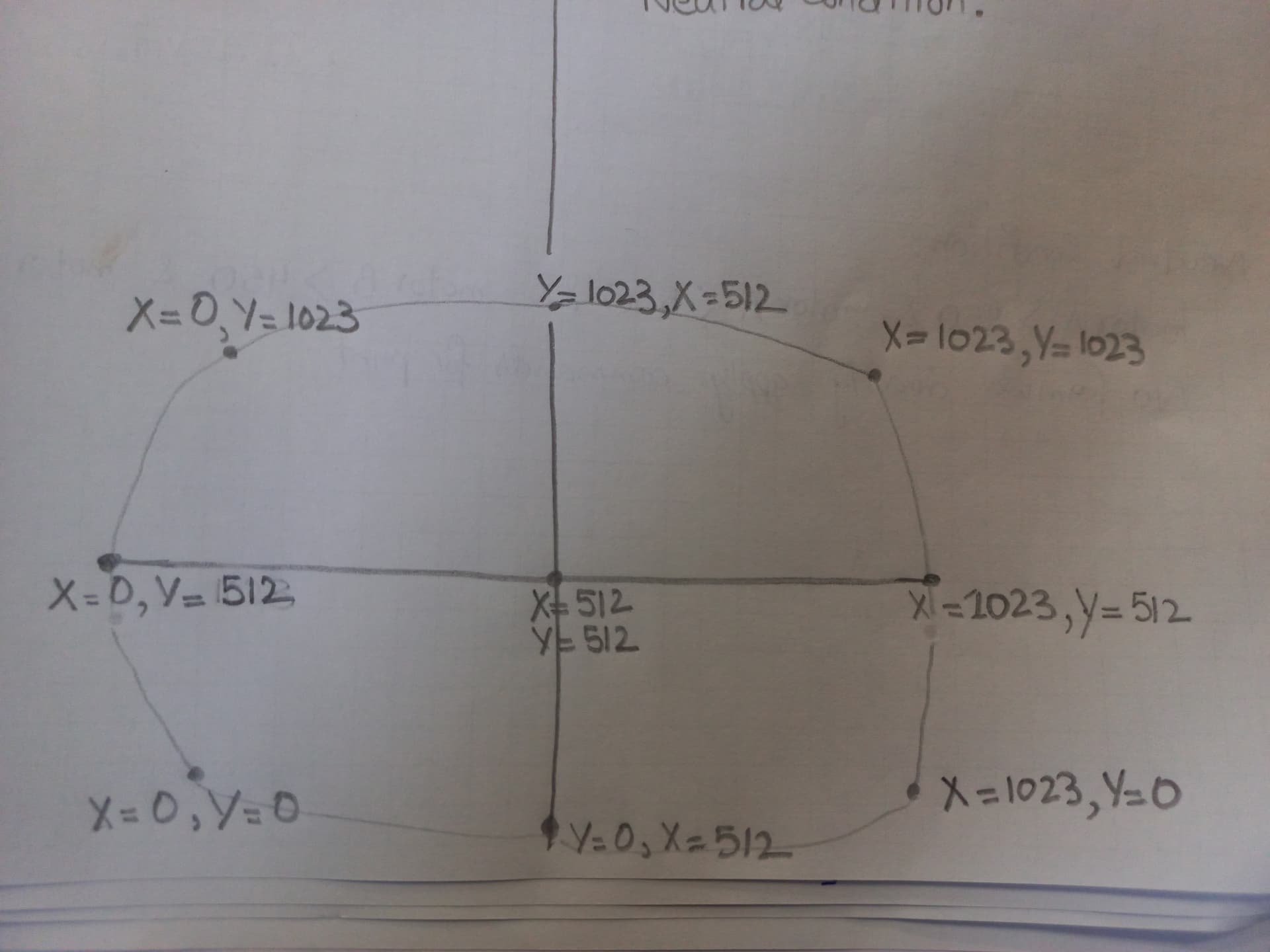

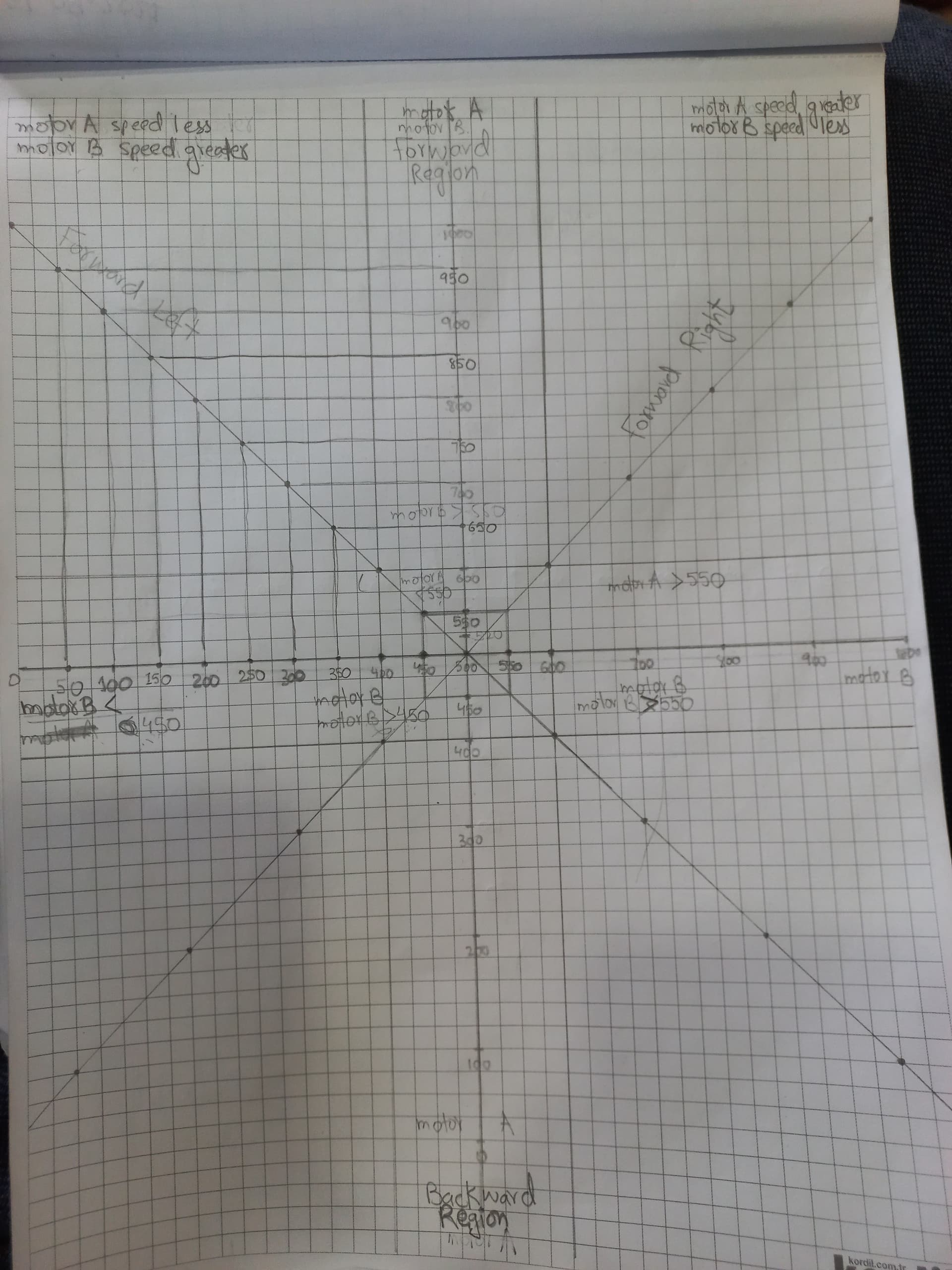

I'm using a two BLDC motors and running it perfectly with a joystick with Forward and Backward Commands. I want to achieve forward left, forward right, reverse left and reverse right but my results were not perfect with this.
Here below is the graph that I sketched, with the help of this graph, I wrote my code.
Joystick Graph is here, i just inverted the X-Axis as well
