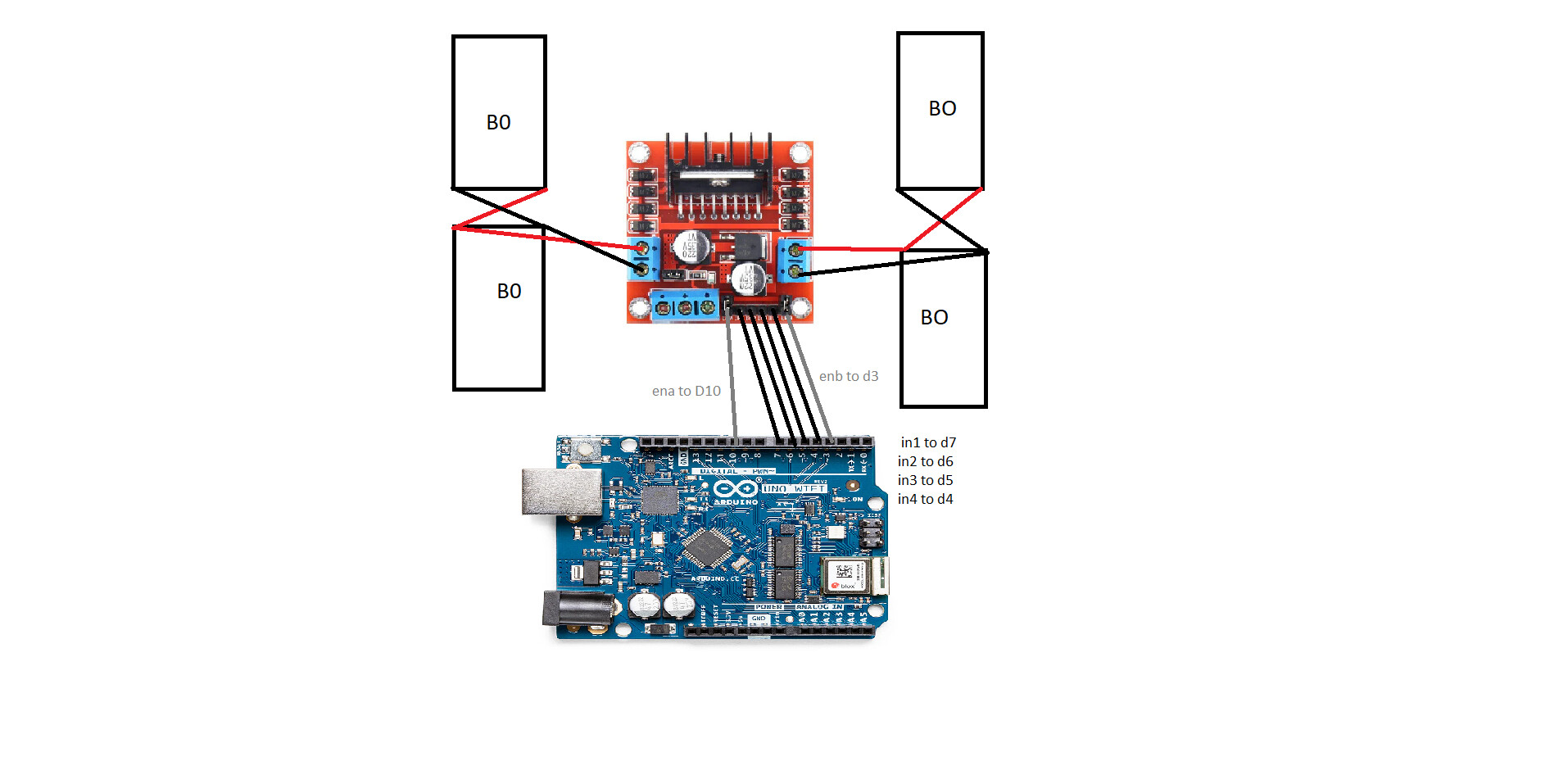

I have problems controlling speed of my DC motors, if I set value to 130 to 250 it works, but if I want to slow it down, it's like It doesn't have power (I don't see logic here, if I have power for full speed, I don't know how I don't have power for less usage), there is picture of my scheme, it's bigger project but I only have problem with this, everything else is working, so I will put only this piece with code

The logic is in the fact that your motors require some amount of power to even begin to turn. Anything below that value means NO turning. The world is not linear. You need to experiment and find the minimum value that will let the motors turn. No guessing!

Can you please tell us the motor specs and what are your power sources.
Like I said, it works from 130-250, so minimum value is 130, but shouldn't it be 0-250?
text is on serbian, but you can see all components, Water Pump, Servo Motor, 5 segment flame sensor, etc.
Motors are not 100% efficient, they need power to just turn themselves over.
If you are using the cheap hobby motors, then their efficiency is not very high.
So you are using the power provided from the 0 to 130 of the PWM value just to get the motor to begin to turn.
What voltage are you powering the motors?
What voltage ratings are the motors?
The 298 driver you are using will drop 2V from your power supply for a start.
It is not a very efficient driver.
