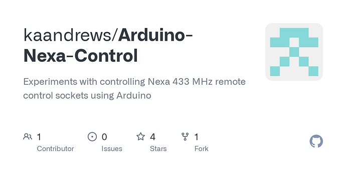

It could be that your 433 MHz sockets use a protocol not known by rc-switch.
I have sockets from Nexa that work totally differently, so I have written some code to read and transmit this protocol, if nothing else it might help you to figure how to control your sockets.
At the moment these are just sketch files, eventually I plan to change them into libraries.
For the 433 MHz I just used some cheap transmitters and receivers from Amazon (around £6 for 3 each!).
Hope it helps!
Kris.

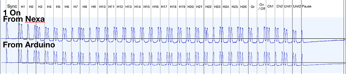

I have heard of people using a sound card and connecting the receiver to it to record the transmission, if you can record a WAV file and get a look at what the transmission looks like then you could quite easily make a sketch to transmit the same code.
That is pretty much what I have just done, but I used a cheap RTL-SDR USB radio to pick up the signal https://www.rtl-sdr.com/buy-rtl-sdr-dvb-t-dongles/ (no affiliation!)
Making the Arduino into a transmitter was a lot easier than programming as a receiver... I've only been using the Arduino for about 2 months and it was quite a challenge!
Just to give an idea of what you can expect I have attached a screen shot of the transmission my my Nexa system and the copy of it transmitter from the Arduino. This shows the WAV files zoomed in a lot on Audacity.

Meanwhile, I have indeed gone down the path of using my audio card in-line and while the first attempt did not produce any results, I realised I had not paired a plug yet, so I paired a plug and then the RC started emitting the expected codes - I guess that made sense to anyone with some experience in the field lol.
I used Audacity and bought a cheap ear-set for $5, ripped off one earpiece and used that to connect to the RF receiver's data pin.
