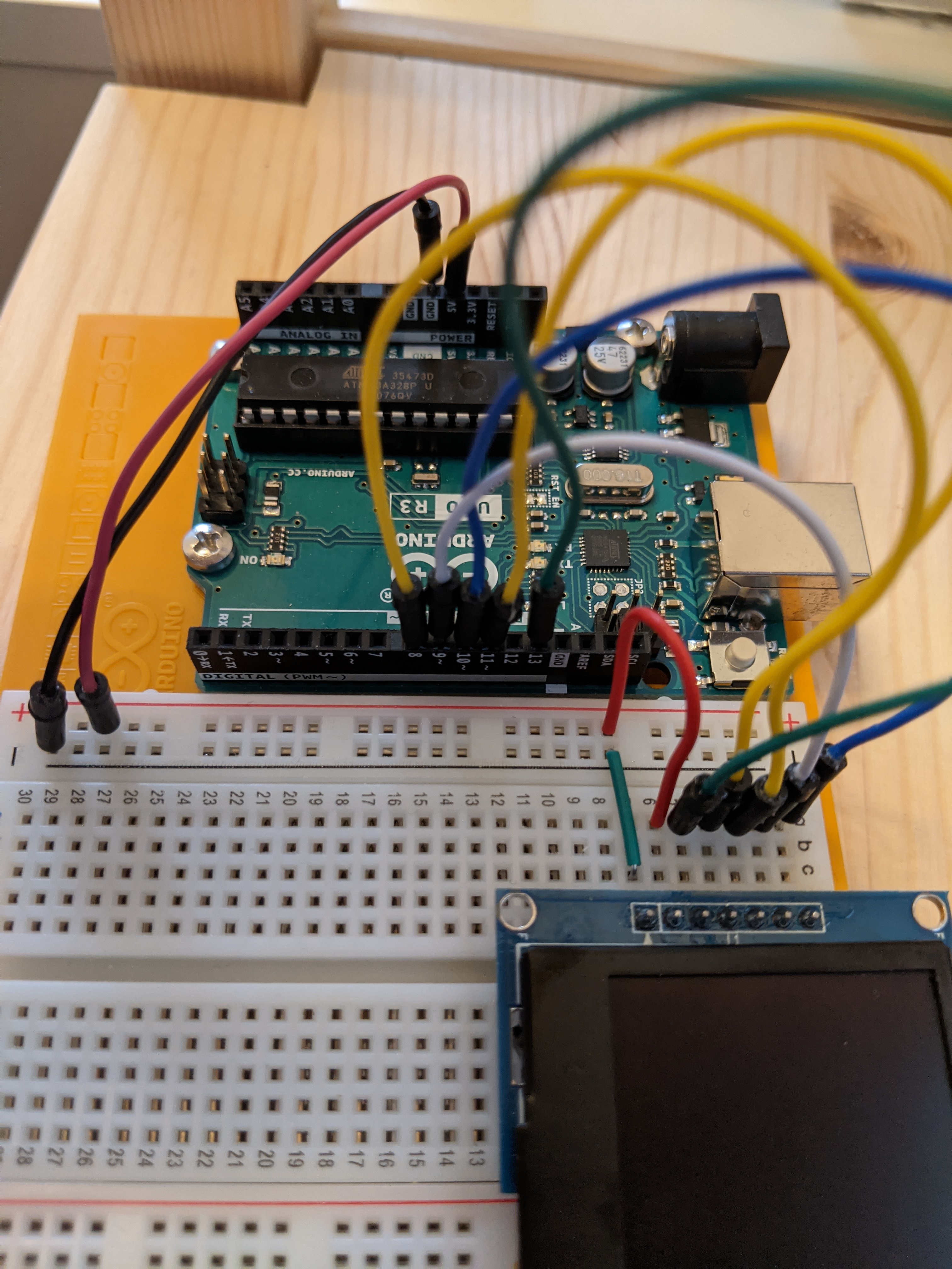

I'm trying to use an unbranded SPI SSD1309 2.42" OLED screen to work with my Arduino Uno Rev3.
Here is the back of the screen:
As you can see, I have removed R3 and soldered a blob on R4, as that's what it says to enable SPI.
Then I connect the screen through a breadboard like so:
This is how the pins are connected:
OLED UNO
GND GND
VCC 5V
SCL 13
SDA 11~
RES 8
DC 9~
CS 10~
There's no schematic of the screen where I bought it from, and I can't find what manufacturer it is. I went off this forum thread for the wiring.
I'm trying to use the u8g2 library which is supposed to work with SSD1309. This is the code example i'm uploading to my Uno. It doesn't seem to matter which constructor I use. The screen is just black, nothing happens.
Any ideas?

You have RES and MOSI around the wrong way.
I suggest that you replace one of the yellow jumpers with a different colour.
Or take a marker pen and paint some stripes on one of the yellow jumpers to distinguish it from the plain yellow jumper.
Bit late now, but it would have been wise to first test with the default I2C configuration and I2C constructor.

Hi!
Thanks for the reply.
So you mean RES should be on digital pin 11 and MOSI / SDA should be on digital pin 8 instead of how I have it now (RES = 8, MOSI / SDA = 11)?
Regarding I2C, is it too late to test? Can't I just jump the correct wires with solder? Or should I not have removed that resistor on R3?
From your photo the SDA pin seems to go to D8 on your Uno with a yellow jumper wire.
And the RES pin seems to go to D11 with a yellow jumper wire.
Which is why I suggested a different colour wire.
I have not got your display. I don't know whether R3, R5 were 0R or some other value.
I do not have the schematic or manual. I don't know whether you needed to remove R3, R5.
It should be easy to follow copper traces and reconstruct the R3, R4, R5 connections to compare with the SSD1309 datasheet.
David.
Sorry for the confusion. I have switched the SDA wire to orange. It goes to D11, and RES goes to D8.
I assumed I should remove R3 because the back of the display says "SPI: R4", "IIC: R3, R5". Maybe I was mistaken. I understand it's impossible for you to know without schematics. Do you know if there is a way for me to make sure the driver isn't dead so i'm not trying in vain? I'm a novice so I may very well have fried it at some point.
Thanks a lot for your help!
Looking at the photo in this link https://www.ebay.co.uk/itm/2-42-inch-LCD-Display-OLED-RGB-SSD1309-12864-SPI-Serial-Port-for-Arduino-C51/152952002220
R4 is 4k7 and R3, R5 are not mounted.
So I would replace your solder blob with a 4k7 resistor and try again.
Personally, I find I2C to be more convenient for small monochrome displays.
But SPI is faster for animations.
David.
Edit. From the DiyMore website:
SPI communication or I2C communication can be switched by configuring three resistors R3 R4 R5.
As for IIC communication, it is necessary to move the resistor on R4 to R3, and R5 is soldered with 0 ohm resistor.
I2C: R3=4k7, R4=empty, R5=0R,
SPI: R3=empty, R4=4k7, R5=empty
Thank you for this info! Will resolder and try again.
Really appreciated!
