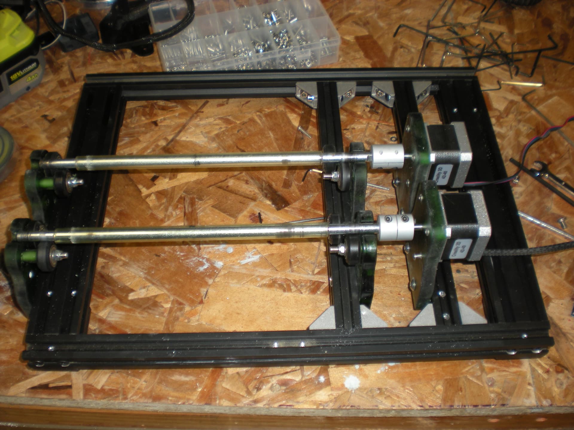

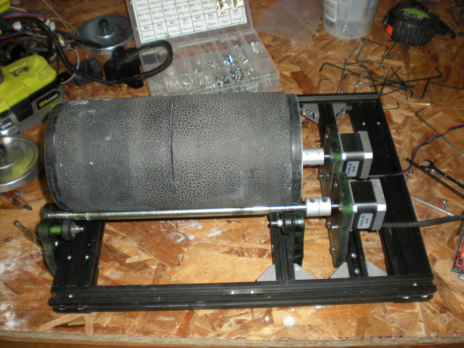

I'm making a rock tumbler out of 2 NEMA 17 steppers and an Arduino Uno with the CNC Shield. I can get it to work, but it's only going about 300-ish RPM. I have a very basic code i'm using and the only variable is the delay, but if i reduce the delay any more the motor just stalls. Is there something i'm missing? The stepper is currently quarter stepped. I can change it to half or full step, but i have to increase the delay to compensate, so it still only goes the 300rpm no matter how i configure it. It's all running off of 12v. Does it need higher voltage? The shield says 12v is minimum.

Why two motors?
Post a drawing of your tumbler.
it's what i have on hand.
power, as it's for (2) 3lb barrels and i didn't think one could handle it.

What is the barrel diameter? What is the roller diameter? What maximum barrel RPM do you want? I would use the MobaTools library for speed ramp up / down.
Is the problem because one motor is dragging the other or pushing the other, causing reverse actions by the motor while it is trying to keep an exact position? What if one roller was freewheeling?

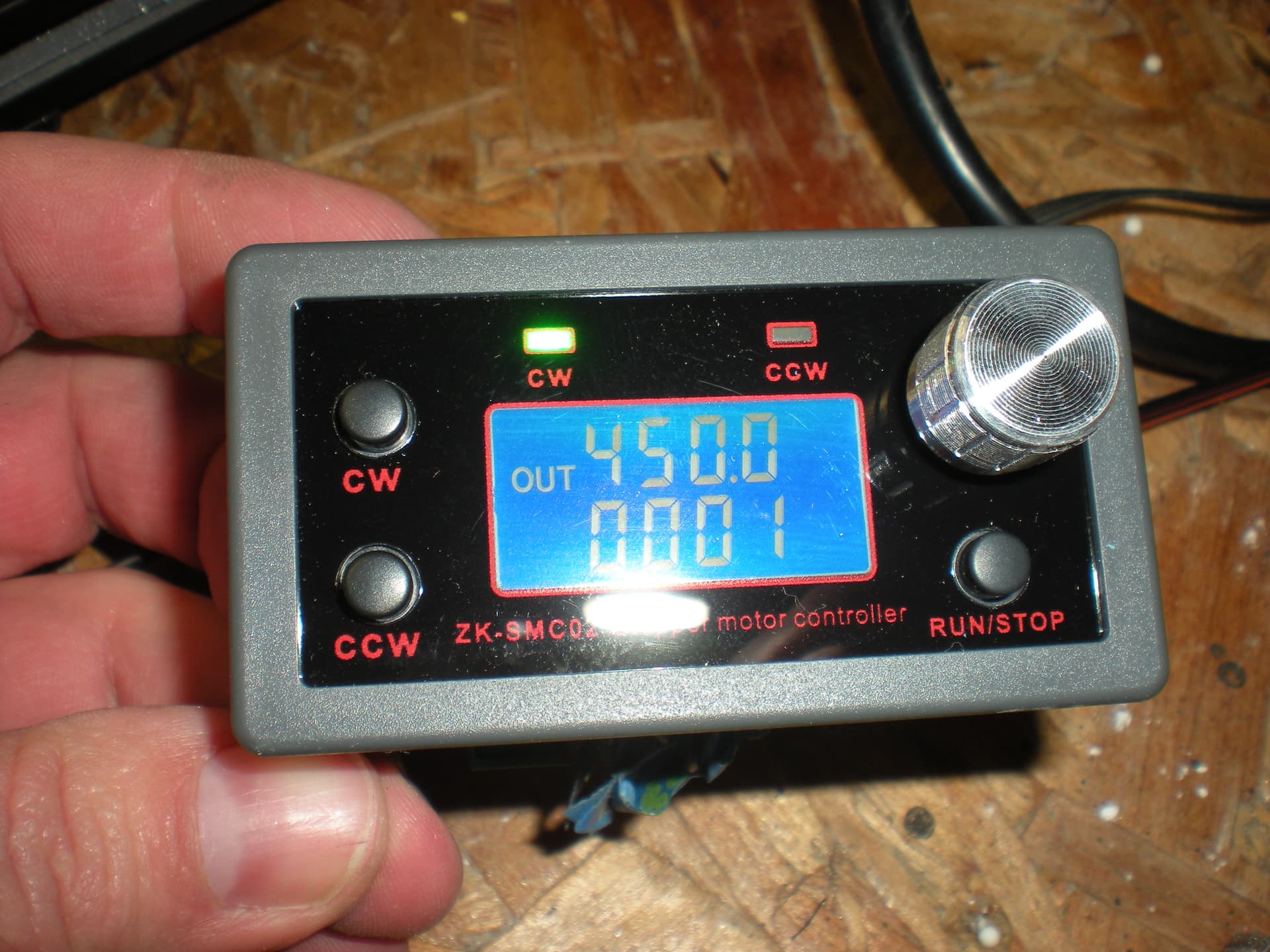

Problem "solved". Got rid of the Arduino and bought a dedicated stepper controller from Amazon.
