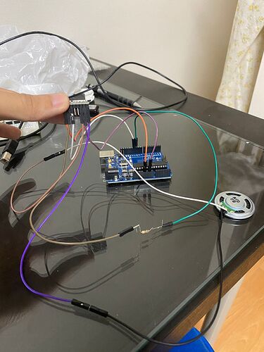

I want to use dfmini player to play Songs on the arduino and output it on a 8 ohm 0.5W Speaker , and nothing is working .I am using the DFRobotDFPlayerMini Library code as is but nothing is playing at all .Attached is Photo of a similar connection like mine and i didnt use a breadboard as actually the DF Player is slightly bigger than the holes. The Arduino Pins Used is 11,10 and 5V and 2 Pins for the GND Here is the Code of the DFRobot Library used as is . The Files on the SD Card are in a folder mp3 and written as 0001.mp3 0002.mp3 ..etc When i Connect and try it out . The Blue Led on MP3 Player doesn't light up , and on the

Please go to Libraries and download DFMiniFast to use as your library. This has come up in the Audio section quite a bit and I think there might be something odd with the Play command in the normal DFPlayerMini Library. Use the Example code and let us know what happens when you try that. Also, is it a genuine DF Mini or a knockoff from Ebay or AliExpress? Lastly are you powering the Arduino from the USB cable right now?

Ok, we know the Arduino is communicating with the DF Mini, so that's good. Now let's ASSUME its a power issue where the LED isn't lighting up. Can you check the 5V line to the Power Pin on the top of the DF Mini and the ground to the DF Mini (that one gets a little tricky as its located between the 2 Speaker + and - pins). If you are using Dupont wires make sure they are tight.
I don' t see your photo, just the crappy fritzing thing.
Which Arduino are you using?

Yes, i am using Dupont Wires , and i made sure everything is fine . Where do think is the problem ? i am also connecting 2 GNDs to the Module if you see the schematic There is one on the left and one on the right

Woah. Hold on. You only need to wire the left side of the DF Mini player. Ignore what is on the Right side per your schematic you have posted. Any chance you can post a photo of your wiring by a photo, can we see it?
Schematic?
Have I missed something?
The fritzing diagram he posted.
There is nothing on the right hand side
I know that this is not the best image
I know there is No GND on the right Side , but thought that this the problem but still it didnt solve the issue
OK- everything on the wiring looks good- the resistor is a little wonky with the 2 male dupont wires but we know the Arduino is communicating. My gut tells me that's a knockoff DFMiniplayer that needs more voltage than the 5v the Arduino can supply. Where did you buy the DFMini from? Do you have a seperate power supply that you can power the DFMini from without going through the Arduino Uno board?
