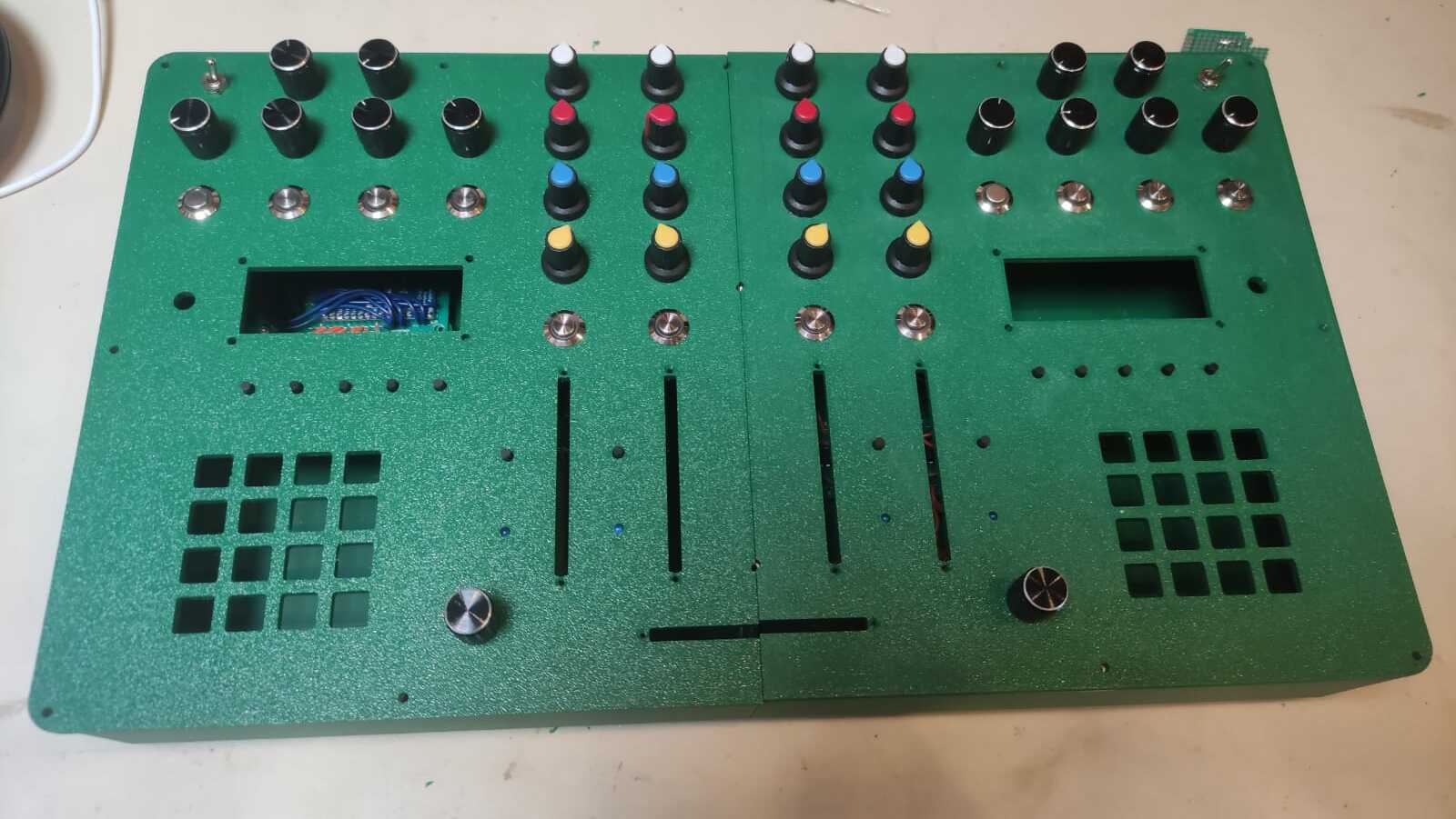

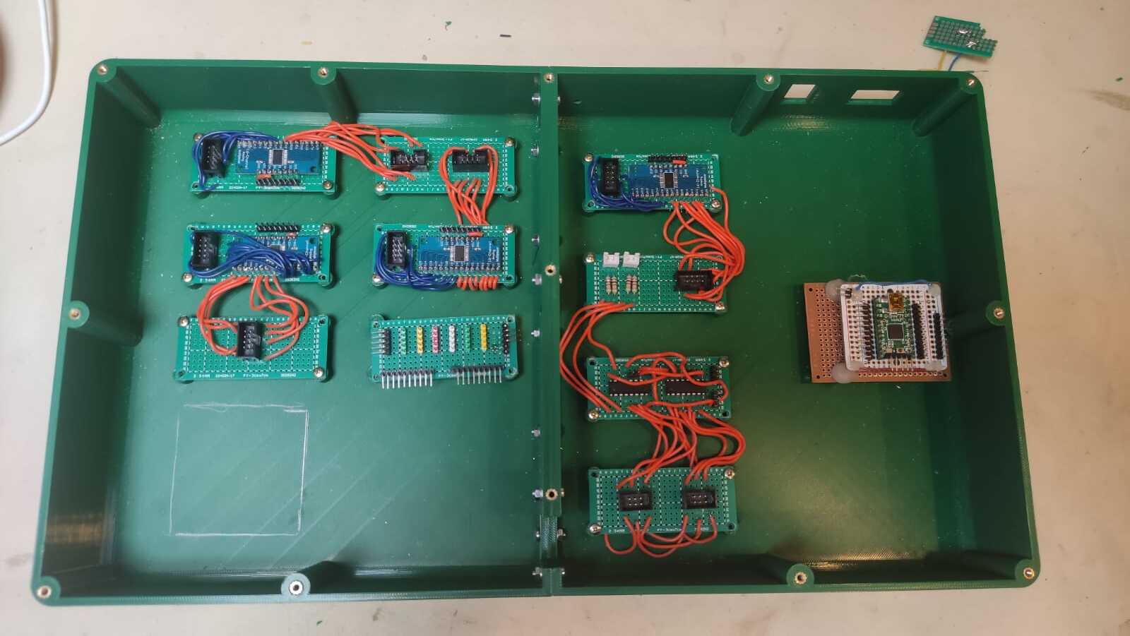

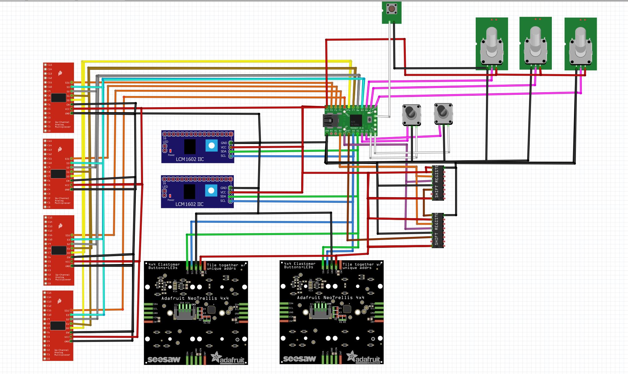

I have nearly finished to assemble my project components (midi mixer) and I woas thinking to add capacitors to smooth out the current in the circuit. Is one capacitor (lets say 500uF) added near the board supply sufficient? I am attaching the schematics of the project. It includes 4 4067 multiplexers driving 32 pots and 32 pushbuttons, 2 shift register 595 driving 16 LEDs, 2 LCD displays (I2C 16x2), 2 adafruit neotrellis I2C, then there are three additional Pots directly connected to the arduino and two encoders. The extra button on the pic is the reset button for the teensy (as you can see I have not included the pots and button attached to the multipexer and shift register in the schematics).
Also I have accidentally shortened pin 9 of the second 595 to pin 10 which is connected to Vcc. I have tested the same thing on a breadboard and it does not seem to cause problems, but what do you think (is it better to take it out again and sort it .... or it doesn't matter since that pin would be not connected to another 595)?

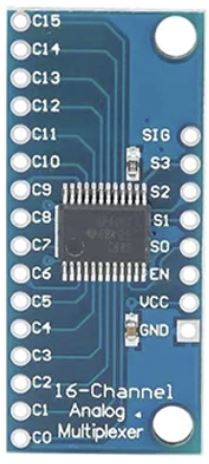

I have checked my multiplexer and it appear that there are two capacitors on the board already; this is the pic from the aliexpress page where I bought them :
multiplexer
So I wander if I should just leave them as they are (just unsure whether to add or not the 47uF one).

Virtually all ready-made modules will have the desired buffer and decoupling capacitors on them.
If you want to add additional buffer capacitance to your project as a whole, a beefy electrolytic can indeed help. For your project, I don't see a need to go higher than 47-100uF. I'd also decouple the power input with 100nF ceramic for good measure, although you'll be hard pressed to note any difference at all in real life.
Why not a single MCP23017? Or a PCA9685 if you want to PWM the LEDs? Or simply an array of 16 addressable WS2812 LEDs that you can control through a single GPIO?
Again, with MCP23017 you can reduce the parts count.
Why not one bigger display?
Test the module in question for functionality; if it still works as intended, I'd not worry about it.
Overall I'd not worry about the capacitors too much, but have another good look at your system architecture in face of your functional requirements (which at this point only you know). I suspect you're not making optimal choices yet.

I didn't want to use LED strip as I am using LED included in the buttons see pics of my project below:

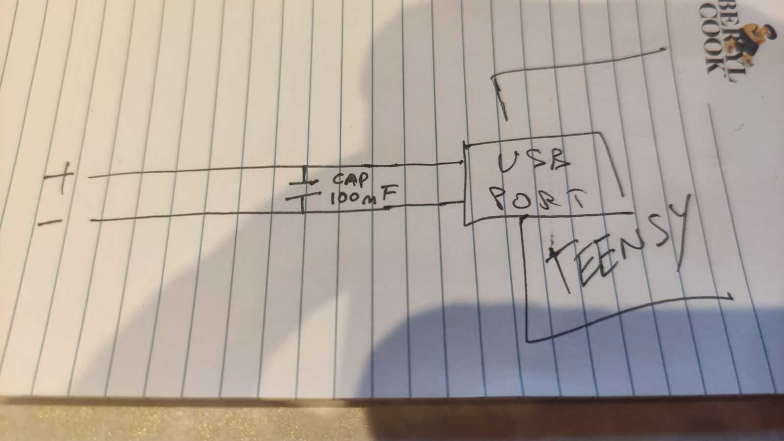

my power input will be the teensy board USB port so I can add the capacitor in this way (in the usb cable) :
but not sure how the buffer capacitor would fit into this if not placed across + and - as the 100nF one.
or am I completely missing the point?
That's right. I did not suggest otherwise.
Place the electrolytic between Vcc and GND of your circuit, close to the USB plug that acts as your power input. The positive terminal of the capacitor goes to Vcc/5V, the negative to GND. The ceramic capacitor: same story.
