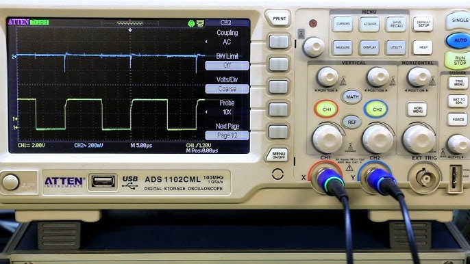

  • Digital ICs demand high currents for short periods of time.
    If you look a the voltage on the Vcc pin with a scope you can see what these demand currents can do to 5v power to the IC.
  • The top trace shows 5v to 0v spikes on the 5v line.
  • These spikes can cause all kinds of digital switching problems.
  • These spikes can affect near by signal traces, resulting in failures in the digital logic.
  • Adding a 100nF capacitor close to all the 5v pins prevents these power line spikes.
