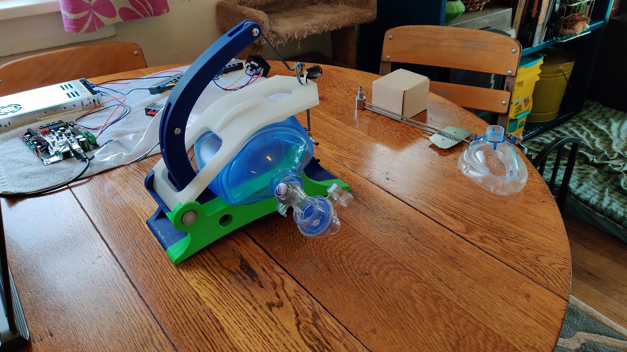

Hi Folks! I've been volunteering my time creating a very cheap emergency ventilator that squeezes a BVM (bag-valve-mask, aka ambu bag) to supply Covid-19 victims with air. I have a working prototype which you can see in the video at the bottom of the post. I come from a 3D printing background, so right now I'm controlling the stepper motor with a spare MKS SBase, smoothieware, and a few lines of basic gcode (G0 X450, G0 X0, repeat ad infinitum). What I'd like to control it with is something like an Arduino Uno, a single stepper driver, and 3 or 4 potentiometers. The three pots control the depth of the squeeze, the speed of the squeeze, and the frequency of the squeeze. A current MIT project shows 4 knobs on their device, and my best guess on that is that the fourth knob controls dwell time (how long the ventilator pauses between squeezes). The problem is, I've never coded for an Arduino and barely even used one. Can I use some basic potentiometers as inputs to achieve this? Can an ATmega 328P issue enough instructions fast enough to something like a DRV8825 to drive a single Nema 17 at something close to its max usable speed? Lastly, I would love a few pointers on which resources I can find to develop the code necessary. Alternatively, if a bored Arduino pro would like to volunteer their time and just donate some workable code, that would be fantastic.
Here's a list of project goals:
  • Keep the hardware as cheap as possible
  • Drive the stepper motor and the arduino off a single 24v power supply (voltage divider for the arduino?)
  • Easily control frequency, depth, speed and dwell time of the stepper motor with knobs/potentiometers
  • Code needs to have acceleration built in to prevent exceeding the Nema 17's torque capabilities
And here is the video of the first prototype:
I should note I'm working with a local EMT and he has also advised that managing pressure in the lungs and ensuring that they are not over-pressured is extremely important. With that in mind, we also planned to add a pressure sensor and a buzzer to indicate when the pressure is exceeded or falls below a lower threshold.
Oh, and depending on what's possible, maybe a fifth or sixth potentiometer to set the minimum and maximum pressure thresholds before the alarm sounds.

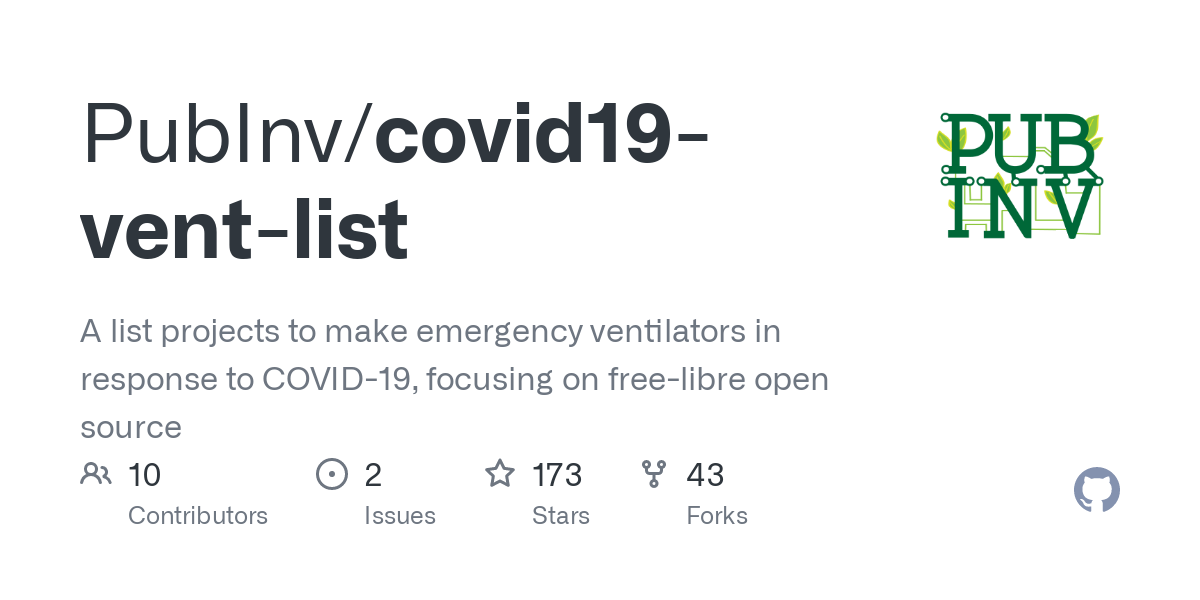

I recommend that you take a look at the existing projects and see if you can help out with one of those, or failing that maybe use some of the information they have published for your own project. Some groups are quite far along with this already, so there's no need to spend time reinventing and getting medical consultation for things that someone else already has done and made open source.
There is a list of DIY ventilator projects, with some analysis, here:
Far better to have one DIY respirator project that gets finished and put in use than 100 half finished projects that never get used.
