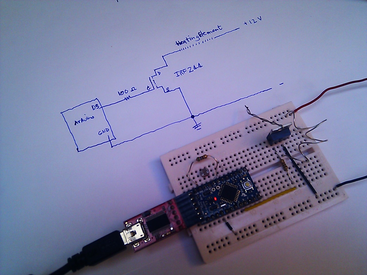

I've just received all part and quickly wired them like this:
FET Gate --- 100? --- Arduino D5
FET Drain --- Heating Element --- 12v +
FET Source --- Gnd
A picture is also attached.
The problem i have so far is after providing full 5v to the FET Gate for a while, the heating element is not heated up. The part that is completely hot is the FET itself. Is there anything wrong in my wiring?

Can you clearly state what type of mosfet you are trying to use? The drawing says IRFZ44 which is not a LOGIC LEVEL mosfet and will not turn on fully with a arduino digital output. You have been told repeatably that you need to use a logic level mosfet.

Thank you for the reply.
I'm using IRFZ44E as kindly mentioned by Grumpy_mike.
I don't know how to check if a mosfet is a Logic Level one.
However, in the datasheet www.irf.com/product-info/datasheets/data/irfz44e.pdf (page 7) it's said something like "VGS = 5V for Logic Level Devices" so i assumed it was OK to use.
Can you please point me to one or two that can replace the IRFZ44?
Searching on google i found some tutorials using IRF630 and BS170. Are these any good?

?? What is the resistance of the heater??
How much current do you expect to put through the heater??
The resistance is about 30-40 ?. The current is 0.3-0.4 A.
did you try to use it, i think it can work .
OK, that's a reasonable resistance and current.
You need a "Logic Level FET" or even a plain Bipolar NPN transistor would probably work fine here....

Hello all,
I just want to say thanks for your input on my experiment.
The heating circuit is working well with both IRFZ44N (from Mike) and IRL540N mosfets.
The heating element in this experiment is silverthread with ~100? resistance. Using thermochromic pigment (operated at 27c) mixed with acrylic colour and painted on t-shirt, the ink fully turns into colourless state within 10-15 seconds. It takes longer than 45 minutes to return to its coloured state. The test was made in 18-20c room temperature.
