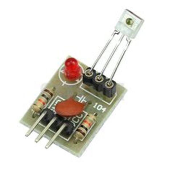

do you think this laser receiver module is better ?
No. Thats an ir remote receiver for commands.

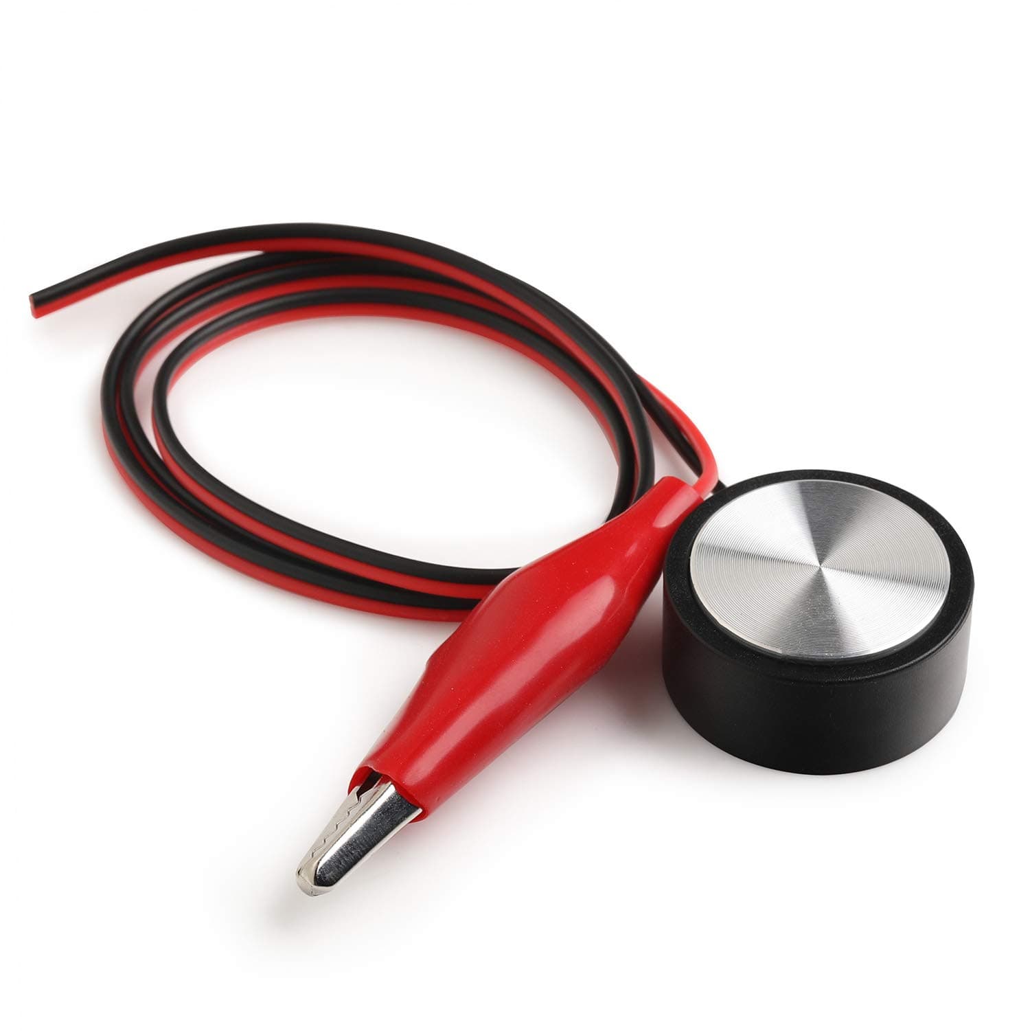

It would be much better to use one of the simple PROBE units.
Probably more accurate too and no need to modify GRBBL.
