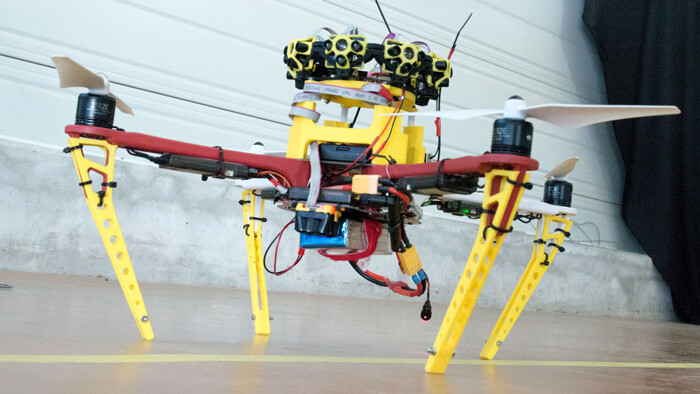

Well, consider that drones don't use their cameras for obstacle avoidance(except some optical flow cameras from what I gather, but I can't speak to their effectiveness or anything else since I don't know).
They use a combination of other sensors to accomplish that, such as lidar, sonar, IMU etc. I don't really know what to suggest in terms of a camera for obstacle avoidance. Even in the best case scenario, consider that you'll likely need more than one. What about reverse or avoiding moving objects from the sides?
I'm not trying to squash your idea, I'm just trying to help you manage your expectations over a range of relevant factors such as price, time, your current skill set and the like.
Trust me when I say I'm well versed in imagining projects (like robots) that turn out to take months or years longer than anticipated (especially when I had no experience), and more than that turn out to cost a LOT more money than I had loosely budgeted.
Whatever type of robot you're planning on building, maybe take a look at what the drone community is doing. The Arducopter guys have been around for years, they have tons of online resources to maybe help you dial in a solution that works best for what you have in mind.
