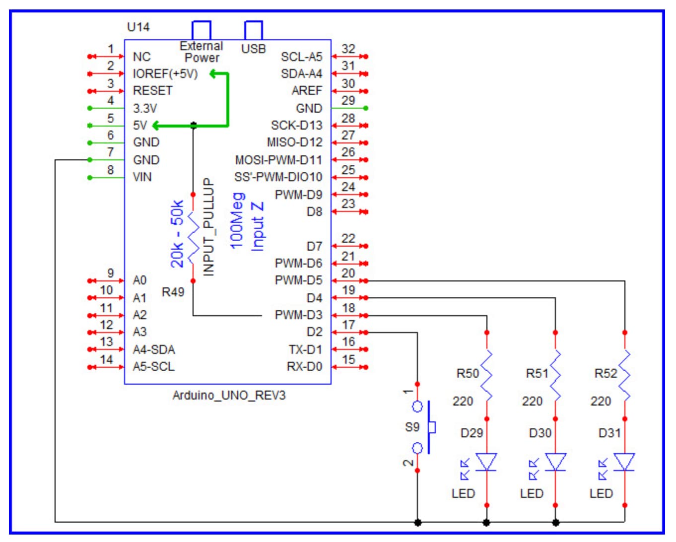

Thanks Larry. It took me a while to find how to reply. I had to switch from Safari to Chrome. The code I have is below. It doesn't have the servo part because I got stuck before that. I took a code that successfully used a momentary switch to turn on a LED and keep it on, then turn on the next and keep it on, etc. When I added the second switch I tried modifying the code, but obviously got tangled up in my own shoe laces.
I've been working from a schematic that you posted back on May 17th of 2017 Larry, trying to modify that. I just copied and pasted it here, but the below came up instead of the schematic.
I think the link to your schematic is: Switch On Multiple LEDs with Single Switch - #10 by LarryD

You have the following line 2 times in setup():
pinMode(pushButton, INPUT_PULLUP);
I assume the 2nd one should be:
pinMode(pushButton2, INPUT_PULLUP);
I would recommend the following changes to checkSwitches():
void checkSwitches()
  static byte counter   = 0;
  static byte lastState = digitalRead(pushButton);
  byte currState = digitalRead(pushButton);
  if (currState  != lastState)
    lastState = currState;
    if (currState == LOW  && counter < sizeof(leds))
      digitalWrite(leds[counter], HIGH);
      counter++;
I assume the second button should do the same thing for the second set of LEDs.

Thanks Larry. No, I'm too new to the code to understand all of it, but I'm trying to learn. Can you explain the functions of the parts? Does the heartbeat timer keep track of how many of the 8 LEDs are on? Are the switches being checked every 50 milliseconds? I appreciate the help.
The purpose of the heartbeatLED to to visually show you if code is executing and confirms it is not being blocked from running.
This code section is not needed for the sketch to operate, it is there to just help you see if things are normal.
The LED will toggle every 500ms if there is no blocking code.
Yes, the switches are being checked every 50ms.
For mechanical switches, 50ms scanning is more than adequate.
