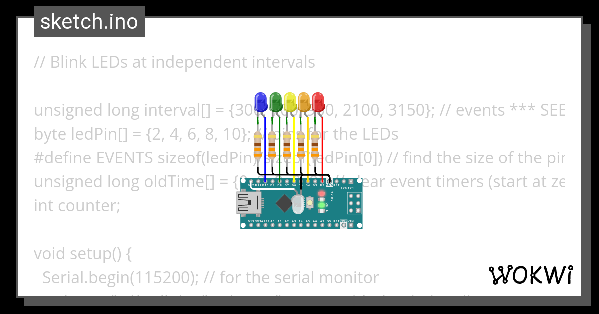

Here are two simulations which might help you toward your goal. The first shows independent timing of several LEDs. Adjust timing by adjusting the array for timing.
The second shows a smaller scale of timing, with one LED using a pulse train to simulate a human, lub-dub, heartbeat while the other LED gradually combines three PWM values to create colors.

Here is a simulation of a Nano enabling relays in sequence. tenRelays - Wokwi ESP32, STM32, Arduino Simulator
You can create any pattern. relay7seg - Wokwi ESP32, STM32, Arduino Simulator
