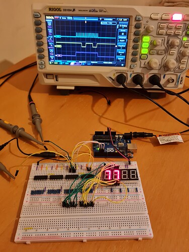

Hi everyone.
I am new to Arduino and new to coding. I have tried to research the answer to my topic but I can't seem to find the right answer. I'm not a programmer of engineer. I'm a technician and a car main dealer and mainly do software updates to vehicles and electrical diagnostics. Anyway enough about me and here is my first code attempt and question.
I have written some code and successfully powered two 7 segment displays and counted to 20. The displays are common anode and the circuit works perfectly.
May question is the code is long and I wonder if there is a better way to write the code? As I'm learning any advice, suggestions or links to reading material would be highly appreciated. Here is my very basic code.

Look at the code for a seven segment library to see how it's done. I've never seen any that were not open source.
You can refactor it into 1/10 of the original length if you use arrays and for loops. Also, use const when defining constants.
All the above are explained in the reference section on this site.
Thank you for the replies. I will do some more studying.
Here is an example of using arrays to greatly reduce the size of a Seven Segment sketch:
const byte Digit1Pins[7] = {4, 3, 2, 1, 0, 6, 5}; // A-G
const byte Digit2Pins[7] = {8, 9, 13, 11, 10, 7, 12};  // A-G
// Segment Cathodes (0/LOW for on, 1/HIGH for off)
const byte Segments[] =
  0b11000000, // 0
  0b11001111, // 1
  0b10100100, // 2
  0b10000110, // 3
  0b10001011, // 4
  0b10010010, // 5
  0b10010000, // 6
  0b11000111, // 7
  0b10000000, // 8
  0b10000011, // 9
  for (int i = 0; i < 7; i++)
    pinMode(Digit1Pins[i], OUTPUT);
    pinMode(Digit2Pins[i], OUTPUT);
void SetDigit(const byte * pinList, byte digitValue)
  byte segments = Segments[digitValue];

Thanks for the replies. Its really helping me learn. I have now advanced to using 2 74HC595 to drive 2 digits on 7 segment displays. I have started using arrays as advised in this thread. Both digits are now counting from 0 to F. I want to next learn how to have each digit count independently. Can you suggest how this can be done? Or point me to some information i can read to learn myself. Here is my code so far:
#define dataPin 2
#define latchPin 3
#define clockPin 4
#define DT 500
byte digits []{
 0x81, //0b10000001; 0
 0xF3, //0b11110011; 1
 0x49, //0b01001001; 2
 0x61, //0b01100001; 3
 0x33, //0b00110011; 4
 0x25, //0b00100101; 5
 0x05, //0b00000101; 6
 0xF1, //0b11110001; 7
 0x01, //0b00000001; 8
 0x21, //0b00100001; 9
 0x11, //0b00010001; A
 0x07, //0b00000111; B
 0x8D, //0b10001101; C
 0x43, //0b01000011; D
 0x0D, //0b00001101; E
 0x1D, //0b00011101; F
 pinMode(latchPin,OUTPUT);
 pinMode(dataPin,OUTPUT);
 pinMode(clockPin,OUTPUT);
 for (int i=0;i<=15;i=i+1){
digitalWrite(latchPin,HIGH);
shiftOut(dataPin,clockPin,MSBFIRST,digits[i]);
digitalWrite(latchPin,LOW);
delay(DT);
Why not just
byte digits []{
 0b10000001; // 0
Strange question. You can already do that, you just chose not to, by shifting out digits[i] and using i twice. If you used some value other than 'i', that's what would be displayed... example:
shiftOut(dataPin,clockPin,MSBFIRST,digits[k]);
If your question is, "how do I choose a different value of 'k'?", then you need to just study C. There are so many tutorial sites online, all you need to do is Google them.
For demonstration purposes you could do something like
k = (i + 5) % 10;
I could but I was playing with both hex and binary.
