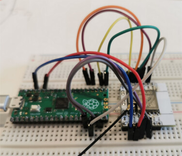

EDIT: looking back see you have a Raspberry Pi Pico RP2040 - you should be able to connect your SX1262 and test it using RadioLib
I have a RP2040 somewhere about will see if I can find it
One MUST be connected, as the transceiver can be destroyed if you transmit at full power without an antenna.
Exactly ! That's why I opened this thread... My SX1262 module has a RF Switch inside, and it is controlled with 2 external pins: RX_EN / TX_EN. But I'm not sure about the polarity of those signals... See the discusion from the begining.
if you have a Raspberry Pi Pico RP2040 this code transmits OK

rather than soldering connections direct to the SX1262 module (photo in post 18) I use (try a search on Ebay)
"ESP8266 breakout board adapter plate for ESP-07, ESP-08 and ESP-12"
remove the surface mount resistors and solder the SX1262 directly onto the pads

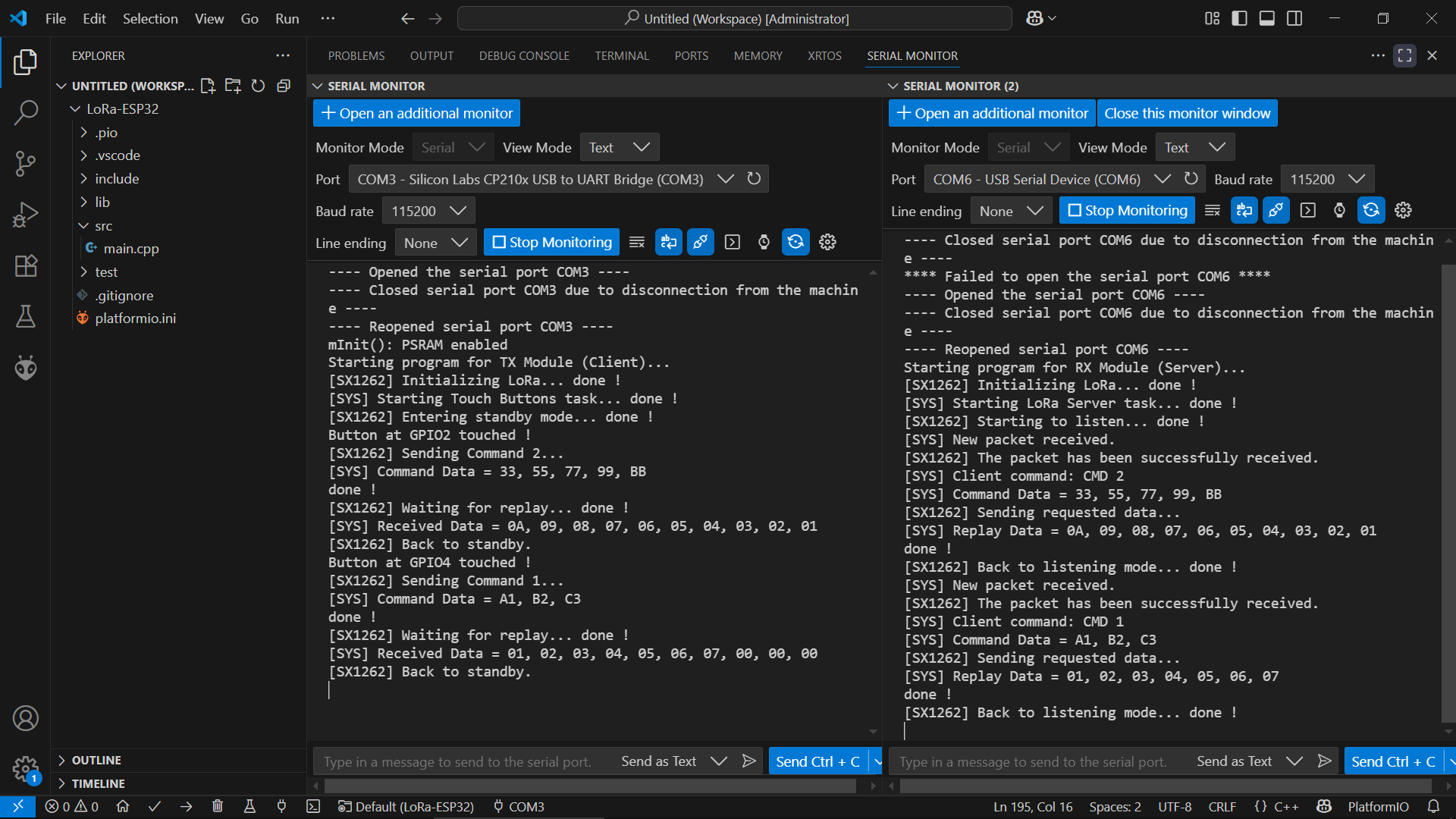

I finally did it: My first LoRa connection ! :grinning_face: After a month of hard working...
I connected both modules to the same laptop and it seems that in VSCode I can open 2 serial monitors at the same time, to watch both modules. The software I made, for ESP32 and for Pico, both worked perfectly from the first time without any errors (I don't think this has ever happened to me, to write a perfect software from the first time, especially since it's also the first time I've used C++ and this LoRa technology).
And now, regarding the RS Switch, it seems that the mystery of the polarity of the control signals of the antenna RF Switch has been solved. I used the polarity that is seen on the @horace oscilloscope and also emerged from the LoRa module schematic and from the logic in the RF Switch datasheet, that is, Reception = RX_EN: High / TX_EN: Low, and Emission: RX_En: Low / TX_EN: High. This was also the default in RadioLib. So those people from Waveshare they don't know what they're talking about when they say on their website that the polarity of the signals are reversed.
Could I be sure that this is the correct polarity, if I transmitted and received correctly ? Or at the 50 cm distance at which I did the test would it have worked anyway, even without antennas ?

#define SYNCW      0xE3    // Sync Word: Custom [Private: 0x12, Public: 0x34]
#define TX_PWR     9       // TX Power (dBm) [-9..22] / with 5 dBi antenna = 14 dBm (25 mW)
#define TX_DC      10.0    // TX Duty Cycle (% percent)
#define PAMB       8       // Preamble Length [6..20]
#define XOV        1.7     // TCXO Voltage (V)
#define LDO        false   // Use LDO only ? [false:LDO and DC-DC, true: just LDO]
The full software can be found here:
https://github.com/MarusGradinaru/lora-p2p
It works on ESP32 and Raspberry Pi Pico.
What do you think ? :grinning_face:
