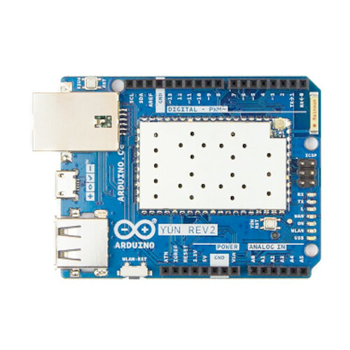

Please, post a picture of Arduino YUN.
Like i said, im not using a temperature sensor. Im using a Pressure Transducer Sensor. But it should not matter what sensor information i read out i guess.
I will post a picture of the arduino Yún and the Sensor im using as well as the NodeMCU.
