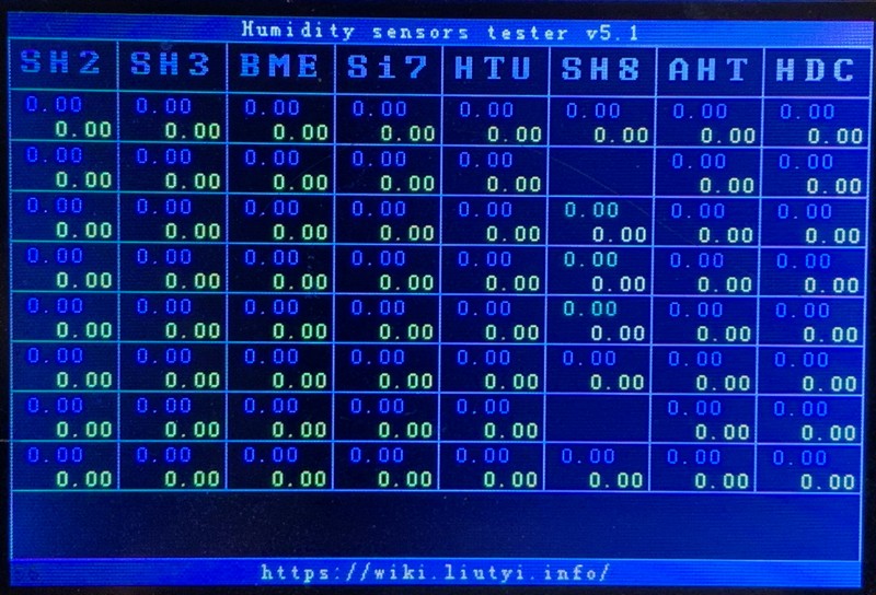

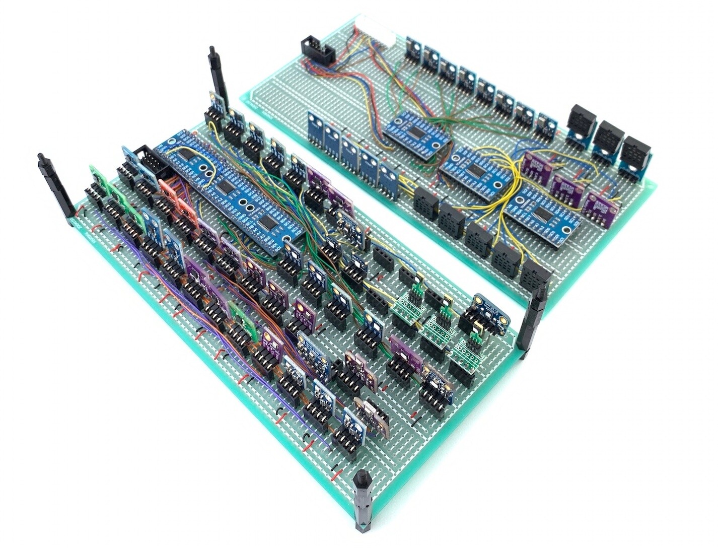

So just simple run of the board gives a total max-min difference for 68 sensors for 20% RH and 2°C
Some sensor of the same type provides similar results some aren't.
Project is still in progress but some data are already available and might be interesting to others planning to use humidity sensor in their project.
See project description:
https://wiki.liutyi.info/display/ARDUINO/Test+i2c+humidity+sensors

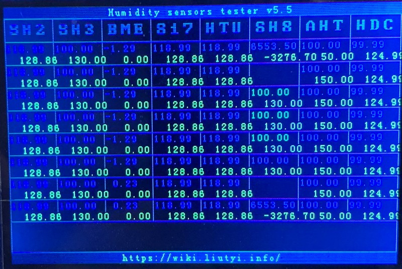

Unstable next (v6) version of board incl. 8xAHT15 (3$) and 8xHDC2080 (4.7$)

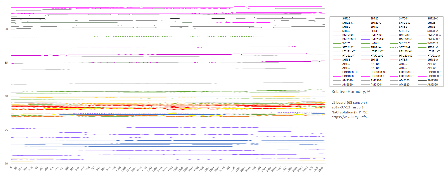

Some high humidity test results
at RH ~75%
https://wiki.liutyi.info/display/ARDUINO/Test+5+v5+saturated+salt+solution
So the RH measurements are:
AHT10, HDC1080, AM2320 - above expected
HTU21d, BME280, BME680 - below expected
Si7021, SHT3x, most SHT2x, SHT85 - expected

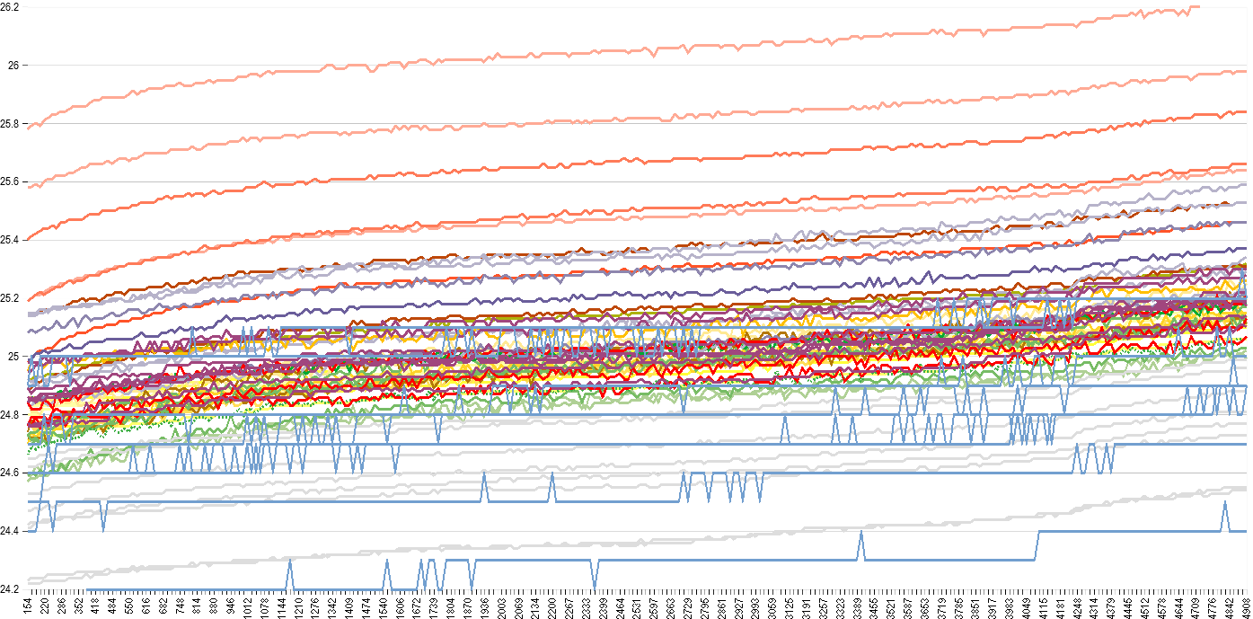

t measurements (using SHT85 as a reference, since no other precision thermometers available)
BME280, BME680 - Above expected

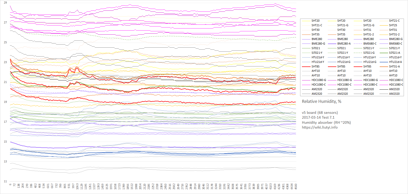

Low humidity (~20% RH) test:
https://wiki.liutyi.info/display/ARDUINO/Test+7+v5+humidity+absorber
Humidity
Low
AHT10 12.1%-17.5%
HTU21d 13.7%-18.8% (one 25%)
BME280 14.5%-17.1%
Si7021 17.0%-18.9% (one 20%, one 25.5%)
Mid
BME680 19.9%
AM2320 18%-24%
SHT85 19%-21%
SHT2x 20%-23% (one 27%)
SHT3x 18.7%-23.6% (one 25%)
High
HDC1080 25.8%-28.4%
Temperature
BMEx60 above expected
