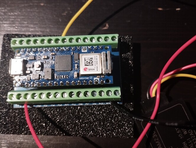

I connected a HT sensor AM2301 to a Nano 33 IoT but the values returned are always wrong.
I correctly connect the 3V3 pin, the GND pin and the DATA pin but the values returned from the sensor are wrong (temp: -3275.1, humy: 49.9). Blowing on the sensor these values change (remaining wrong) so I think the sensor is anyway good.
I use another, identical sensor but the result remains the same.
The software part is correct but I'm not sure about the wires connection. Some online examples report the use of a 10K resitor between VCC and DATA pins.
What am I doing wrong?
The sensor red wire (VCC) in connected with Arduino 3V3 pin
The sensor black wire (GND) in connected with Arduino GND pin
The sensor yellow wire (DATA) in connected with Arduino D6 pin (digital GPIO

I don't know the solution but if you just want to know about a 10k resistor then I suggest you try it. I doubt connecting a 10k resistor will damage anything. If it doesn't solve the problem then to get help you will need to provide the requested information.

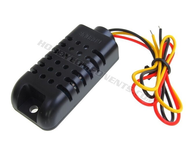

According to the AM2301 datasheet, the manufacturers suggest a pullup resistor of around 5.1kΩ.
See page 5 for further details.
I used a 10K resitor and a 5K6 resitor but nothing seems to work.
One thing remains: the voltage.
The sensor documentation reports that its voltage can be from 3V3 to 5V but the 5V is preferred.
Arduino Nano 33 IoT use 3V3 as output voltage and I'm using that.
I will try to feed the sensor with 5V.
If you do this, you will need to verify that the data out does not go to 5v along with the supply.
You may need a voltage divider as the The Nano33 IOT is not 5v tolerant.

I'm the writer of the DHTnew library and some other DHTlibraries too.
For 3V3 boards I would advice a 3K3 or even 2K2 resistor
if the wire is longer than ~25 cm = 10"
Can you run the sketch dhtnew_pulse_diag.ino and post the output?
(5 dumps ~ 30 seconds is sufficient)
It does check dump the low level timing of the sensor.
