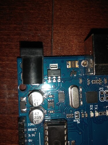

Post a picture of YOUR arduino, close up and in focus, especially the chip next to the USB! Hopefully we can figure out WHAT chip it is and give help. If you cannot take an photo, give us the letters and number from the top of that chip.
The driver is in the driver folder, supplied with the IDE, that is NOT a CH340 chip.
