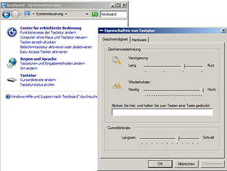

and the last thing what i need to update is. in the current state of te code, when i hold the key, it prints that letter in some interval. But on the computer keyboards, when i press and hold the key, it prints one letter, then it waits like 0,2 sec, and after that it prints that letter in interval, idk, 0,05 sec.
yup
and it will work so if:
You need to keep track of the state of each key and call "Keyboard.press()" when the key is first pressed and "Keyboard.release()" when the key is released. Your current code is sending press and release for each key that is held down for each scan of the keyboard.
