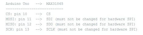

I am trying to do a PT100 temperature sensor and MAX31865 board project with Arduino, the code and wiring are working perfectly.
The thing is, I want to add more than one PT100 and boards to this projects (I need to have 8 sensors) but the communication pins are predefined in the library and I don´t know how to change them:
pin 11:MOSI-SDI
pin 12: MISO-SDO
pin 13: SCK-SCLK
If these pins were modifiable I could defined more sensors, right? I mean, 3 of them for each sensor.

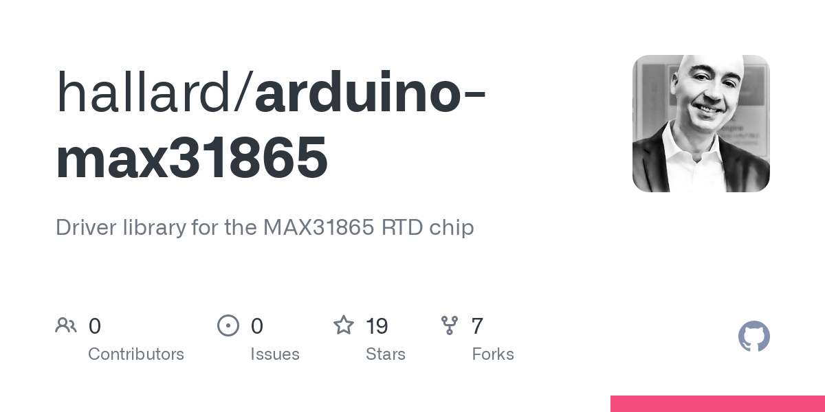

This is te library:
In the images attached you can see that the sensor is working on the serial and the communication pins i mean.

The board has SPI bus interface. All boards would share the SCK, MOSI and MISO pins (SPI bus). Each board needs to have a separate chip (slave) select (CS) pin. In code the CS pin is set to active for the board that you want to read.

#define RTD_CS_PIN1    53
Here is where you tell the sketch which pin are to be used as chip selects for the individual boards. You need a pin for each board. So:
#define RTD_CS_PIN2  54  // or pin of your choice
For the second board
MAX31865_RTD rtd( MAX31865_RTD::RTD_PT1000, RTD_CS_PIN1, 3875 );
MAX31865_RTD rtd2( MAX31865_RTD::RTD_PT1000, RTD_CS_PIN2, 3875 );
This where you create an instance and assign some constants. Configure a different RTD_CS_PIN for each instance. I made the second instance separate for readablity and changed the CS pin.
rtd.configure( true, true, false, false, MAX31865_FAULT_DETECTION_NONE,
                 true, true, 0x0000, 0x7fff );
This configures an instance of an rtd. You will need a configuration for each instance.
rtd2.configure( true, true, false, false, MAX31865_FAULT_DETECTION_NONE,
I will leave it to you to find out what all those parameters mean.
So now you have 2 instances created and configured rtd (CS=53) and rtd2 (CS=54).
rtd.read_all( );
rtd2.read_all( );
I cant test this but hope it helps.
