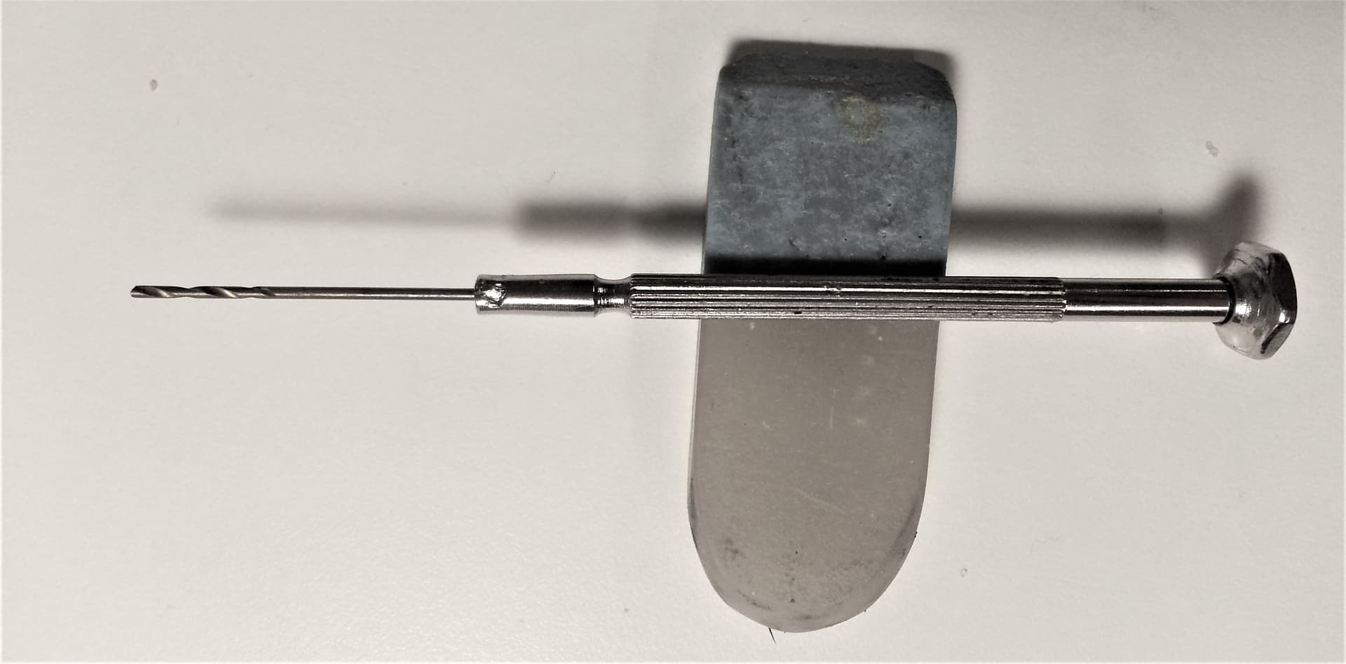

For cutting tracks on a PCB I use the point of a modelling knife spun around to make a tiny perforation in the copper track then use a 1mm twist drill mounted in the shaft of a (broken) jewellers' screwdriver to cut the through the width of the track. If necessary, then a larger drill in a hand held chuck to finish it off.
