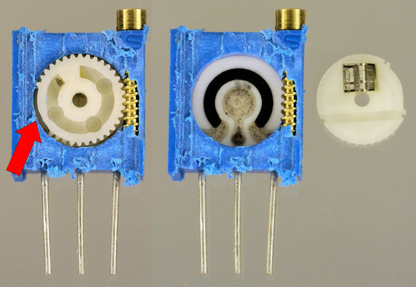

Got it to work but only after about 30 turns. Then it follows the ten turn interval like you mentioned.
Not sure how that's possible looking at the inside of one of these things
...But o well, glad to know I wasn't completely lost. Simply didn't give it enough turns.
