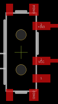

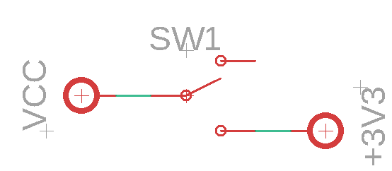

Hi guys, I just designed a SPDT pin but I don't understand it, is the picture correct?

Your diagram appears to show a switch that can connect the VCC pin to 3.3 V
Is that what you want to do ?
Yes, that's right. I still don't understand about the smd switch.
The SMD switch footprint shows 3 connections to its contacts but you cannot tell from the footprint which pad is connected to which contact internally
It would be conventional to have the centre pad, ie pad 2, as the common connection and for the other pads to be the NO and NC connections of the switch but it is impossible to tell from the diagram or image of the footprint whether this is the case

Your footprint does not match the one in the data sheet. The pin numbers are reversed and it looks like some of the pads are larger.
To be sure everything is right I would find the correct footprint for that switch.
Also if you show the pin numbers on your schematic, it would be clear as to what is connected to what.
Ok if you can tell me just tell me which pins i need to change i just want to connect from battery to switch then go to esp 3v pin
You can connect Vcc to pin 2 and 3.3V to 1 or 3 and ignore the other pads.
However, I would make sure that is the correct footprint for that switch and not wait till you get the PCB and find it does not fit.

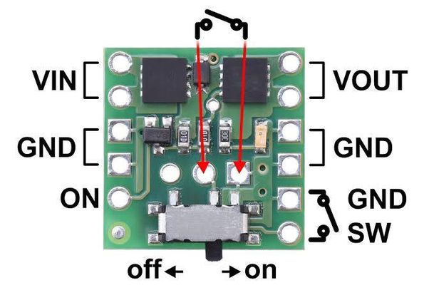

I saw someone made it like this using pin 1 for the ground path, I'm not sure
457659081_3919867938241737_4469261163720791256_n
But there are also those who explain it this way
s-l400
I just need clarification on which one is correct
