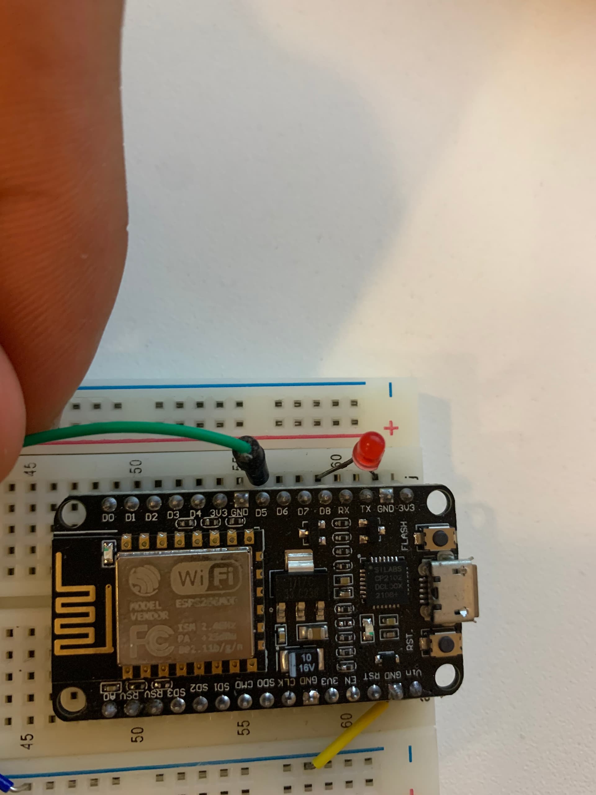

hello, i want to be able to push a button that is connected to arduino uno and in response, an LED connected to nodemcu will light up. I dont know how to wire up the esp8266 to arduino, and i dont know what should i put in code. Can someone help me? Thank you.

i tried to run uno as an output and esp as an input and didnt work, i dont know why
Probably time to share what you tried.
A schematic and sketch goes a long way here.

In the tx/rx example above, there exists a "receiver" and a sketch for the receiver, and a "transmitter" and a sketch for the transmitter. You are only showing one sketch. Do you have both? Would you try the configuration and sketches from the example link? Which device is your transmitter and which is your receiver?
i never got to tried the method with the rx/tx, the sketch from above is for setting the arduino as output pin and the esp8266 as a input pin. I connect the 2 pins using a voltage divider 1k,2k, but i dont know why the esp266 is fried after trying to connect to arduino
i have another esp but i dont want to do the same mistake
You load the same sketch into Uno and esp8266 to configure each? How does the host (uno/esp) know if it is tx or rx?

this is how i wire the esp8266 and arduino, the rezistors are 1k and 2k,

its correct the way i connected the nodemcu with the uno ?
