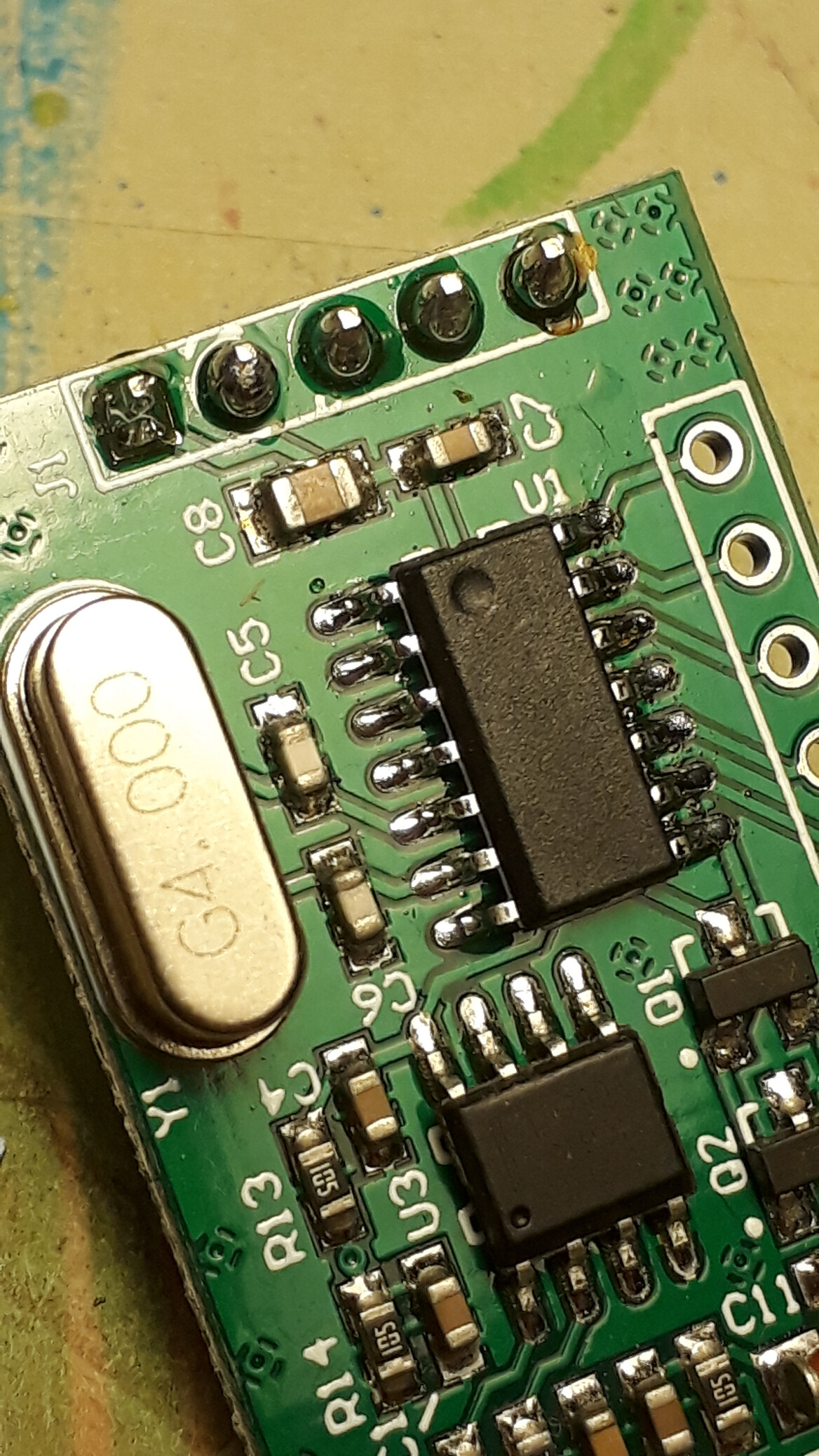

Unfortunately, there is not any good manual or datasheet for the RFID module. In the description (see screenshot); it just mentions the pins on the module that are 5V, GND and TXD (no RX?). And that the output interface is UART (9600, N, 8, 1). At the moment I am not receiving anything if I hold a 134khz tag close and my serial monitor stays empty. So I am not sure if it is a wiring issue, or a coding issue or both....As said I am rather newbie and thus would appreciate any help. Has anyone worked with such a module?

The specs for your board state UART which is indicative of TTL signals. However, this can be verified with a magnifying glass and reviewing the ICs on the board. It is difficult to tell in the photo with having no schematic.

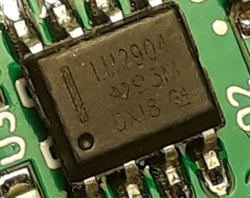

I tried to check with the magnifying glass: The smaller IC says something like LM2904 but the larger one has no indication on it at all. Does the information about the LM2904 already help, it seems to be a general purpose op amp...Unfortunately the board does not have any schematic or more specifications about the IC etc.
The issue of whether the board output is R232 or TLL has been solved.... I again connected the board directly to the arduino without the R232-TLL converter and I somehow managed to receive a signal (so TLL). I am not sure exactly what solved the problem, but I rewired everything (so maybe a broken cable before) and what I realized is the the antenna only recognizes my tag if it positioned in appr. 90 degree angle; if the tag is positioned parallel to the antenna nothing is received (which makes technically sense).
