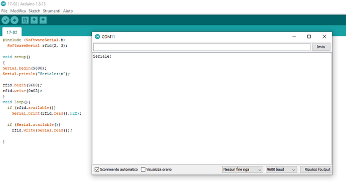

I made the connection between the Arduino board and the module in this way:
Arduino || Sensor Pin
GND - PIN 1 (GND)
5V - PIN 2 (VDC)
D2 - PIN 4 (TXD)
The code I've tried, to check and write the read RFID code, is the following:
#include <SoftwareSerial.h>
SoftwareSerial rfid(2, 3);
Serial.println("Seriale:\n");
rfid.begin(9600);
rfid.write(0x02);
void loop(){
if (rfid.available())
Serial.print(rfid.read(),HEX);
if (Serial.available())
rfid.write(Serial.read());
But I've not any result in Arduino IDE Serial Monitor.
I hope that you can help me, thanks in advance.

Bottom right on the serial monitor, dialog box: is the number in that box 9600 or something else?
Yes, thanks, the data rate is equal to 9600 baud.
I'm afraid that the problem could be in the code, I wish to see on the monitor the code of my cat RFID chip, that is at 134.2kHz frequency
Your picture shows a Mega... No need for softwareserial
Connect both RX and TX-lines to reader
(Serial speed can differ from Serial1 speed)
Serial1.begin(9600); // speed for Rfid-reader @ pins 18/19 - verify correct speedsetting
not the data rate. the Serial Monitor rate.
Sorry, I meant serial monitor data rate.
Is it correct? But no results
it is right. as noted above, on a Mega, you have 4 hardware serial ports. you don't need software serial. you have 3 serial ports available on pins:
14 - 15, Serial3 TX - RX
16 - 17, Serial2 TX - RX
18 - 19, Serial1 TX - RX
In which way could I edit my code, avoiding the use of SoftwareSerial?
Excuse me, but I'm a beginner with Arduino
Thanks everyone for the help
remove the top two lines
include these in void setup:
    Serial.begin (115200);                                  // set serial monitor rate to 115200 here and in the serial monitor
    Serial3.begin(9600);                                  // GPS Serial setup
    Serial2.begin(9600);                                  // Sound module setup
to read Serial3, put Serial3 where you have rfid
if you use more that one SoftwareSerial port, you have to tell SoftwareSerial which port to listen to. these Mega ports are hardware ports, they can all work simultaneously.
