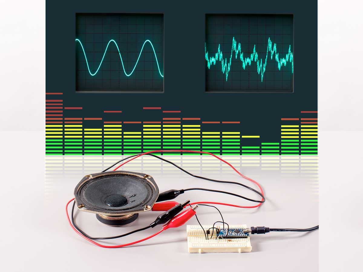

So I've been looking at building a synth with an arduino. I read a lot of articles that were telling you can't connect headphones to the arduino because of the input impedance and the square shape of the signal.
I came across this article (link below), which basically calculates a wave and sends it out as a fast PWM signal. By connecting an RC-filter, they get an analog signal that varies between 0-5V.
Would it be possible to connect headphones to the output of the filter? Or will I still have problems?

That transistor circuit driving an 8 ohm speaker is a very cheap/cheerful solution to the impedance issue I suppose. Puts DC bias on the speaker though which could be fatal to headphone drivers alas...
Amplifier chips are the way to go really, yes.
