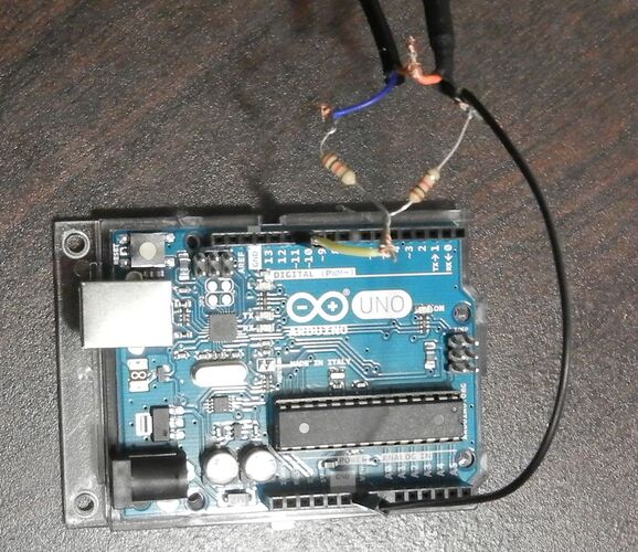

@jremington, I think I did wiring according to your diagram.
It seems to be working perfectly! Thank you for your precious advice!
I m going to use some solder and shrink tubing to make it a little more robust.

Looks OK, glad to help. Soldering connections is always a good idea.
