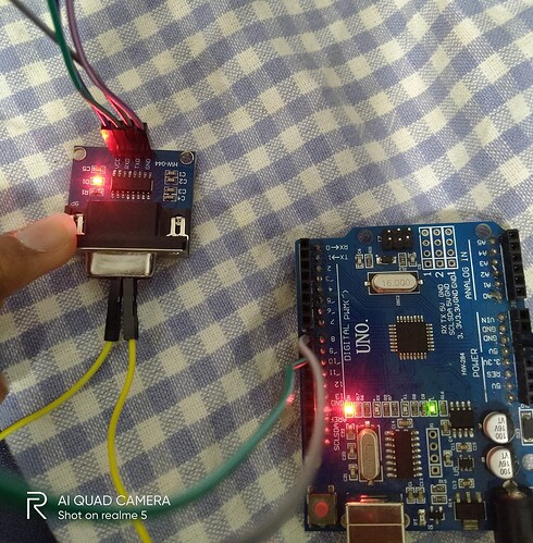

  1. I am using arduino uno (smd version , attaching the image along)
  2. I had used rx,tx pins of compass and arduino but it did'nt work because as everyone mentioned we need to use RS232 and probably send a command in hexadecimal to start operating the compass.
  3. No, HCM375 does'nt come with a 9 pin D-type connector , however I used one to connect it and make it work on it's own software, which worked perfectly fine. (also attaching the pin configuration of compass)

I connected all pins in the way you mentioned, however this only worked when I simultaneously used compass's 'Rion' software along with the arduino. But it didnot worked when I separately used only arduino and compass with the connections mentioned above.
@horace
Thankyou for loopback test code.
I have tried and obtained the output shown below. I tried to enter few characters on serial monitor they were sent but never displayed. Is my output shown correct ?
connections are
RS232(vcc-5v)arduino
RS232(gnd-gnd)arduino
RS232(RX-8)arduino
RS232(TX-9)arduino
did you try connecting pins 8 and 9 of the UNO to do a loopback test? did t work OK?
when the RS232-TTL module is connected to the UNO try connecting pins 2 and 3 of the D-type connector - this should form a loopback test to check the RS232-TTL module is working

First you should only have the Uno and compass connected, nothing else should be connected to RXD, TXD
Second what software are you using on the Uno to communicate with the compass?
connect D-type pins 2 and 3 together - the transmitted signal is fed back to the receiver to form a loopback

Please check the connections below and inform my mistake.
try swopping pins 8 and 9 on the UNO
marking can be ambiguous - does Tx mean transmit out of device or transmit into device
Connect as I show in post #8 using the HW-044 converter, Vcc is 5V.
Only connect the Uno and compass, nothing else.
What software are you using on the UNO?
