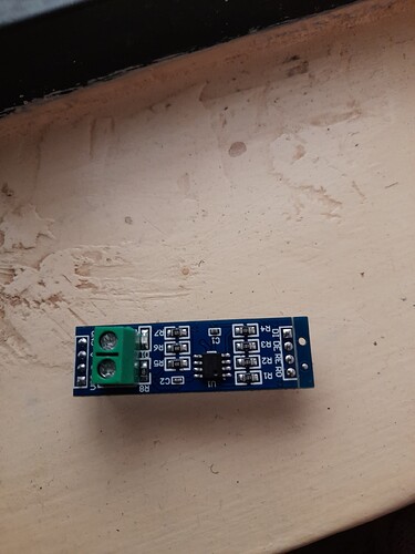

  • Which RS485 module do you have?
  • How have you wired the RS485 module to your Arduino?

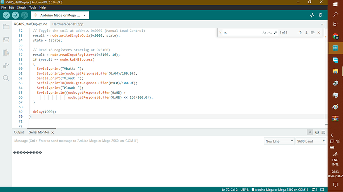

So this is my connection. I'm using an Arduino Mega 2560 and
This attached is the RS485 image

Ok, the first obvious thing is why are you using pins 0 & 1 for the RS485 comms? This is a common fudge on an UNO when people don't use a software serial port.
You have a MEGA2560 which has 4 hardware serial ports and you are using the same RS485 module that most others also use.
  • Move RO to the RX1 pin, and DI to the TX1 pin.
  • Add in a Serial1.begin(9600) below the existing Serial.begin(9600).
  • Change node.begin(1,Serial) to node.begin(1,Serial1).
You should now be using hardware serial port #1 for your modbus comms and the standard serial port for all your uploading and printing.

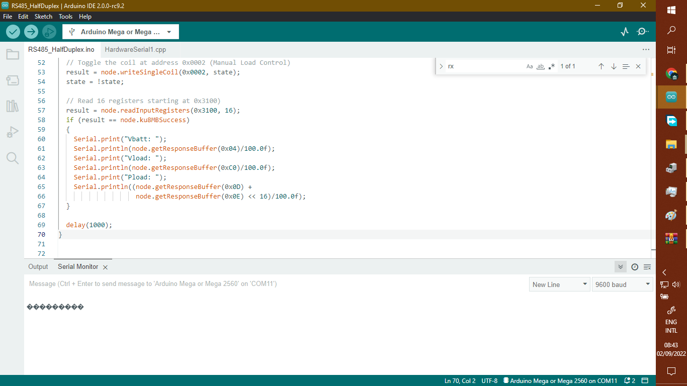

Hey, the output seems to be unknown characters but everything is ok, including the baud rate
