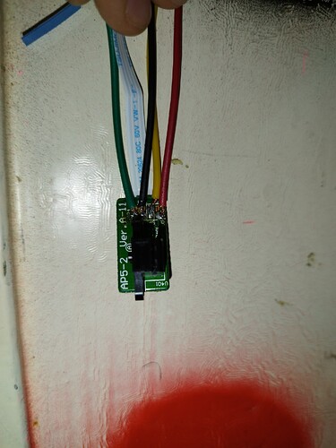

Hello, i have the solution for the connection of epson's encoder (epson stylus sx 125), so i tried it like it's mentionned in the pict and it works!
red : positive (+)
black : GND (-)
yellow : Ouatput A
green : Output B

This thread could be of much greater use if you would post a schematic.
