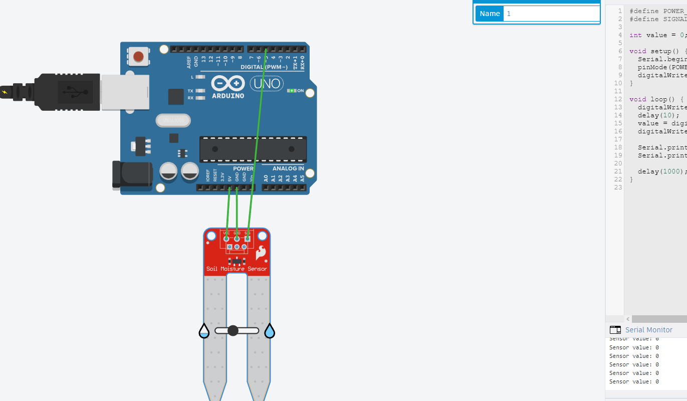

Hello, I just fried Arduino UNO R3 by my fault and meanwhile I get new one, I need to solve this problem. I am using LCD display (connected to SDA and SCL ports), 4 soil moisture sensors on pins A0 - A3, and other not important parts in my project. Problem is that I wanted to connect Water Level sensor to pin A4, but as A4 and A5 are directly connected to SDA and SCL pins, I cannot use it on any analog pin. So the question is, can I use the Water Level sensor on Digital pin? It should output only 0 or 1, is that right? Thats how I want to use it, only if there is, or is not any water, I dont need the exact water height. Also, when will it output which value (0 when in water or 0 when dry) and does it need to just touch the water or it needs to be like halfway in water to change the state of output? I havent found anything, so you can send links if there is mentioned the Ditigal pin. If anyone could at least maybe try it for me, that would be also helpful.

UPDATE: I tried this in TinkerCAD, but with Soil Moisture sensor, as none of the simulators have the Water Level sensor... It worked like I want it to, but will it work the same on the WL?
There is another module for that sensor that will convert the output to a digital signal (On/Off). It is basically a comparator with an adjustable reference (potentiometer). My sensors always came with that module. You can also get a I2C A/D to read it.

ANSWER: New R3 came today, the sensor doesnt work without the Soil Moisture converter module, but with it it works as intended on the Digital pin.
