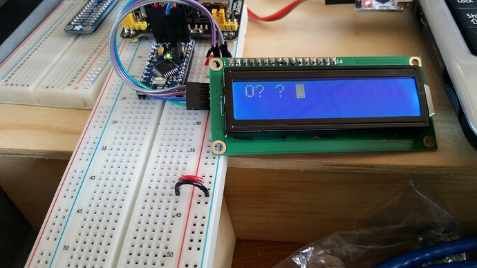

I am using a Pro mini clone, 1602A v2.0 white on blue LCD, and a unmarked I2C backpack with PCF857 chip; all purchased cheaply via auction site.
The screen displays BUT, it appears to be blue text instead of white, like the text is inverted and nearly impossible to read. Adjusting the potentiometer on the backpack will dim the display to nothing, but that is all. In the first pic you can see a faint 'Hello, world!'. That is the best readability I could get. (The unconnected LCD and backpack in the pics are identical to the ones in use (that I soldered together before testing).)
The second pic shows an interesting accident - I disrupted the wiring to the backpack while troubleshooting using a more complex sketch and the screen displayed two updating characters - but at full brightness and contrast! Proof of operation? Any clues?

Thanks for the reply Don. It may be hard to see in the picture, but the LED indeed seems to be on, it is just the text that is not illuminating correctly. Pulling the jumper off the backpack I can clearly see the LED turn out.

EDIT- The constructor was printed to the screen, but I could just barely see it. Check out the pic. Any ideas?
OK I see that now. Maybe it is indeed a contrast problem!

It looks like the screen pixels are the opposite of what they should be; they should be white, not blue. The characters on the screen are actually darker than the background. Does that make any sense?
I don't know if you have any data sheet on the lcd you bought, but it looks like a positive, transflective model. Often, these require negative contrast voltage.
I don't quite remember the procedure, but Don recommended one using a battery to check this out. Start by grounding the contrast pin and see if it improves.

The fortuitous second photo gives the clue. There is a bad connection in there somewhere - check pins 1, 2 and 3 on the backpack/ LCD assembly for starters. Second to that, check the voltages on those pins (pin 3 should be set around 0.5V).

Trying the display without the I2C adapter gave same inverted contrast.
Connecting only the power and ground on the backpack gave me a lit screen with no pixels visible at all (adjusting contrast did nothing).
At Paul's suggestion to check the voltage on pin 3, I took a multimeter to the power supply rails and I only had 3 to 4V! I looked up from my bench to see that I was feeding my breadboard power supply from a 5V wall wart...
Don asked me if I checked this - and I just confirmed my jumper position and moved on. --> He had this solved this two days ago if I had only listened explicitly.
Supplying the incorrect voltage to my breadboard was causing the crazy dim and inverted contrast. My 5V pro mini was working just fine on this low voltage. Moral of the story: Breadboard power supplies like the one I was using must be supplied with more than 5V in order to feed 5V to the breadboard. I found a 12V wall wart I had lying around and the screen lit up bright as day, perfect contrast!
I then hooked up the original lcd via I2C backpack and it worked right off (pic) with the manufacturer supplied sketch.

Let me explain a little more about what happened here. Not only was your pro mini working on the lower voltage, the LCD module was working as well --- except for the contrast.
The contrast voltage is specified with respect to VCC not GND. Typically this voltage is around 4.5V less than VCC which would be 0.5V with respect to GND when operating with a 5V supply. When you operate this same display at 3.5 V the required contrast voltage would then be around -1.0V but the best you can get with your potentiometer is 0v.
This is true of virtually all voltage regulator circuits. There is a minimum input-output differential required for them to function properly. This differential is typically at least 2 volts but there are 'low-dropout' versions that require less.
